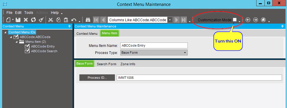

Big RED FLAG WARNING… This one will bite you until Epicor “fixes” it (I reported it, and believe it is fixed in the next version).
This screen in Context Menu Maintenance has a “hidden” checkbox called “Customization Mode”… if you DON’T click here, then all the context menus you add are “personal” and invisible to the other users.
So… upon entering the program, just click the box, THEN start adding new context menus.
