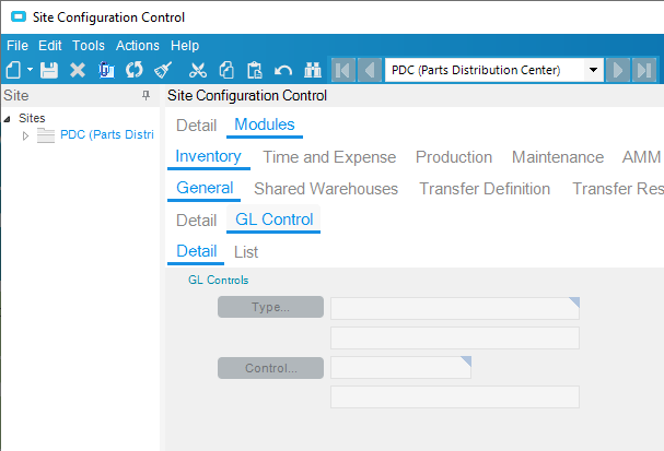

Question # 1: What in blazes does this GL control do?!
Either I have never seen it come up in the hierarchy manuals, or I have been confusing it with the Site Maintenance GL Control. This might explain why the PE Log Viewer sometimes says it’s unable to find “Seg2 value,” when I know I set up GL controls on the site and warehouse.
And then the really confusing thing to me, is that there is no GL Control Type associated with the Plant Configuration entity.
And I see that I could add the entity to an existing Type, or create a Type from scratch, but that’s like partial differential calculus to me.

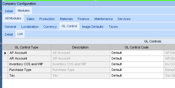

Question # 2: are all the GL Control Types set up by hand in a new Epicor launch?! Or does everyone have “AR Account” and InventoryCOSandWIP" and “Plant Transfer,” like the pic below? If these are standard, why do I not have any Type tied to the Plant Config entity?
It does EVERYTHING!!!
But seriously… It is what controls which GL accounts are used by the various processes with specific Contexts.
Yous should have a minimum of the following Control Types (probably more)
Note that they all use a GL Control Code named “Default” . But those are actually 5 different GL Codes - which I created. They would have been better named “AP-Default”, “AR-Default”, etc…

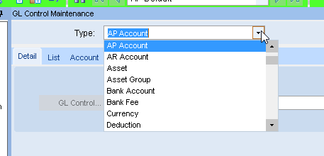

So there are GL Control Types - like:
And each GLC Type can have one or more GLC Codes .

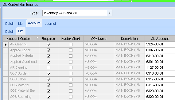

For example, we created GLC Code with the following:
  • Type: Inventory COS Default
  • ID: Default
  • Set the GL Accts for the specific contexts
Then in Company Config, we added a new GLC
  • Selected Type Inventory COS and WIP
  • Selected Code: Default
Now any GL transaction related to COS Material (like when a shipment is invoiced) will use GL acct 6316-00-01.
Other GLControls can override that. But that is the last one in the heirarcy (like when no other GLC applies).

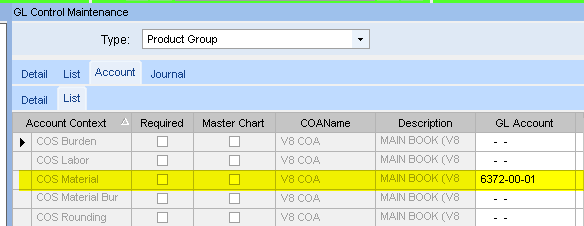

But since we want to break up COS Material by Product line, we do that by creating GLC’s of type Product Group. Here I was smart enough to prefix every GLC Code (for GLC Types Product Group), with “PG-”
For example, A GLC Code was created with:
  • Type: Product Group
  • Code: PG-CABL (I name them “PG-” + the ProdGrp Code)
  • Set the COS Material Context to use GL Acct 6372-00-01
Now if an Invoice line specifies a ProdGrp of CABL, the GL Acct 6372-00-01 will be used.
Any other Prd Grp (or an unspcified PrdGrp), will use 6316-00-01 (the one specified at the company config)

That screen shot in Question 2 shows the Types. I think it is rare that you’s add any types.
What you need to do is create codes for those types (not necessarily all of them), and then assign those codes as needed.

I’m asking about the specific one in the first picture of my first post. What does that one do?

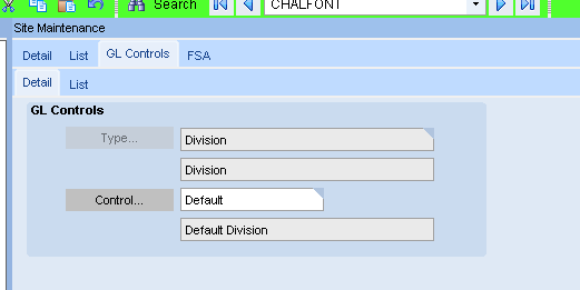

But we do have ones on Site Maintenance:
edit
And Type Division is the only built-in Type you can assign to a Plant Maintenance

Well I need to give support the benefit of the doubt sometimes. I put a ticket in (after everyone’s responses here), and they answered it quite well this morning.
There’s an article, KB0030729.
But short answer is, it’s not used and obsolete, but can be used in a customization if desired.
I’m lost as to how they mean a BAQ, but I’m not adventurous with finances anyway.
Text of KB article:
The General Ledger GL Control assigned through the Modules tab within the Site Configuration for Inventory Management is not used in out of the box rules and is not loaded as part of the VBD for COS and WIP Capture. Even if you have some GL Controls assigned there it is not used in the current rules and you will not be able to include it in the input document unless you were to use a BAQ. It is obsolete for our Standard Posting Rules, but technically you can create a customization that can use it (though not in really convenient way - BAQ).
