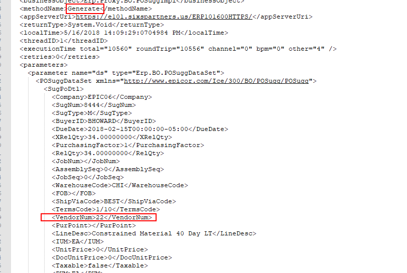

I can’t even get the vendor number from the POSugg.Generate BO.
Why not? that’s there
Not sure.

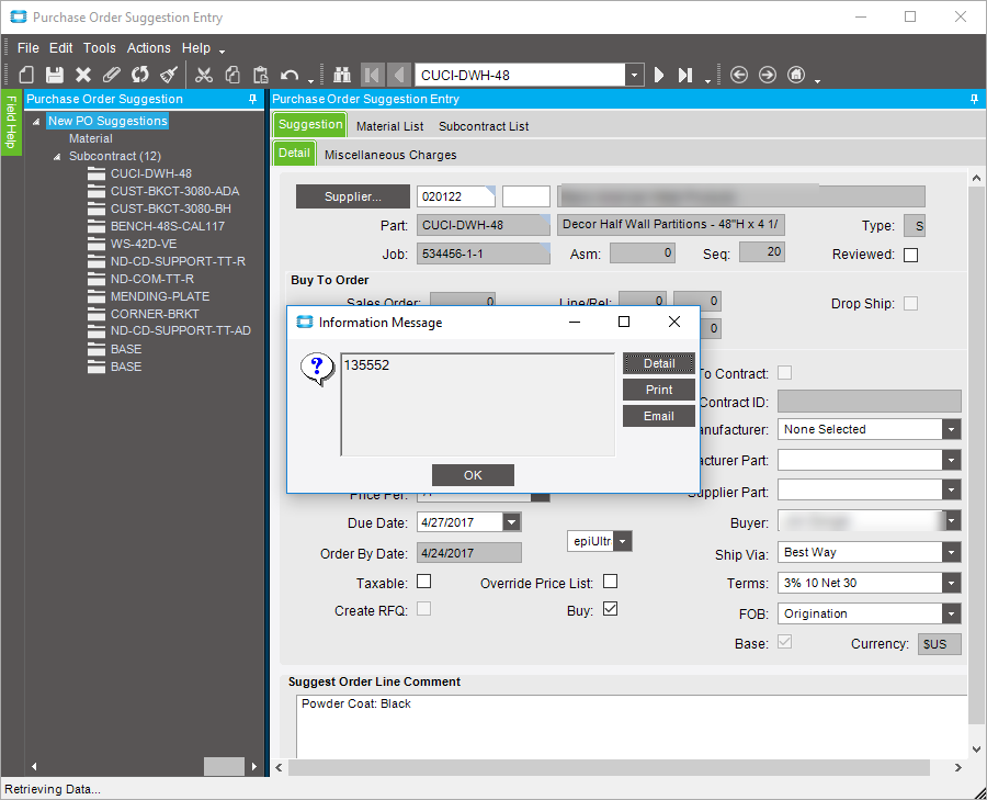

I just put in a message widget to spit out the vendor number and it came up blank.
Did you put a RowMod condition on it? If so that’s your problem the record is there but it isn’t RowModed… Also you could use the SugList parameter and split it and do lookups in code
