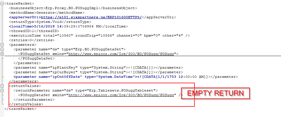

Adding Attachments to PO Lines during PO Generation/Creation within New PO Suggestions
According to my trace your ttPOSug should be empty in post Proc… Did you click “BUY” on these suggestions? My spidy-sense says this shouldn’t be working
Yes, they were marked as “BUY” and then I clicked generate.
Well… sh*t I’m dumbfounded… oh well if it ain’t broke… however I believe this will fail if they click “BUY” and then leave the screen or clear it and come back and hit generate later. I believe generate doesn’t actually care about what you have selected on the screen it generates ANY PoSug with the Buy Checkbox whether it is in the screen or not…
Not sure if that matters in your case but try it, open po Sug, Mark Buy… clear screen , load another POSug, (don’t mark buy) hit generate. I believe the original PO sug will still generate and its information will NOT be in the ttSug table.
Boo, you’re right. It did not work.
I’ll have to mess around with this some more tomorrow…
You may have to try that Pre DD Post hack that should work regardless of which SugCreated since you’ll be triggering on Data Directive POHeader.Added… what a pain
