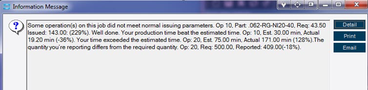

Adding Carriage Return Line Feed to Informational Messages
Is it possible to add carriage return / line feed to informational messages to structure them better?

What works in form code? I’m trying to display the ShipTo address but + Environment.NewLine + doesn’t do anything and seems ignored as everything is bunched together.
			if ((edvOrderHedRow != null))
				edvOrderHedRow.BeginEdit();
				edvOrderHedRow["InstallShipTo_c"] = adapterRow["ShipToNum"];
				edvOrderHedRow["Character07"] = adapterRow["Name"] +  Environment.NewLine  + adapterRow["Address1"] ...  [Country];
				edvOrderHedRow.EndEdit();
