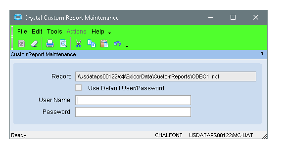

In E10, I get a “blank” run report window that launches when I click the menu Item added as above.
I don’t have to actually fill in the name or password.
Clicking the Preview button launches the CR runtime viewer.

When I click the preview button in 8.03 it asks me for this information:
Ahhh yes… That’s looking for connection info to the Progress data base.
You’d need to enter the username and password from PET (Progress Explorer Tool). I think the defaults are ‘progress’ and ‘progress’
