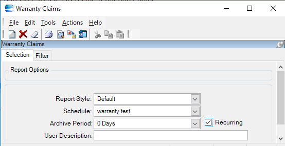

I’m trying to schedule this report to be automatically e-mailed out, is that possible in Vista? I created a schedule for it in System Agent, however when I go to the report to add it as a task, it doesn’t save my changes when I select the schedule and recurring on the report. How do I get the schedule/recurring to save?
Hmmm… I forget how to do this in V8.

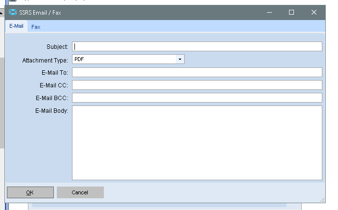

In E10 you would just act like you are manually emailing the report (using the email icon - which V8 doesn’t have), but with a schedule selected first.
After clicking the email button, you get:
Fill in the fields, and hit OK.
Instead of instantly generating the report, it sets it as a task based on the schedule selected (#2 in the first pict)
Yeah I don’t have that option in Vista 8. I thought maybe if I set up a system agent and schedule, then add the report as a task on the schedule I’d be able to e-mail that way. But like I said, when I go into the report screen and hit drop down for schedule, nothing saves.
I don’t even recall how to create an email of a report in V8.
