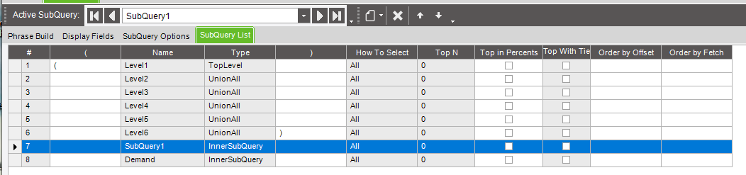

So here is what I have. I have added the Demand query to the top Level but still says number of fields do not match. Level 1 – Level 6 are all derived from SubQuery1
Dumb questions, So you brought the subquery into every single one of those levels right?

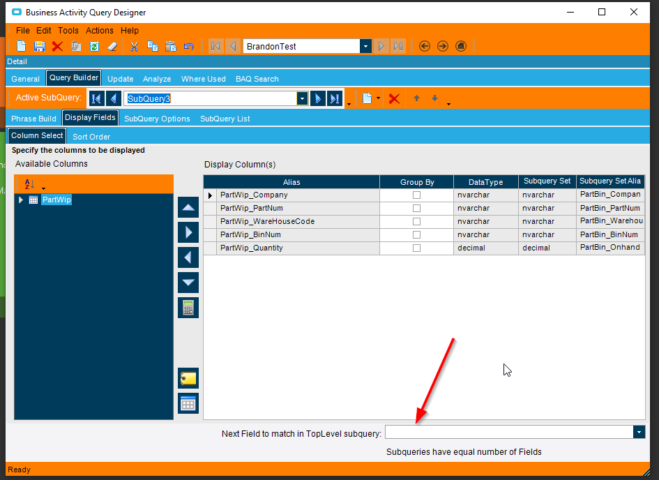

to check the field, go through each of the levels and look at right side of this grid, and look at the bottom bar. If you have all of the fields, that should be blank. If there is something in there, it’s looking for another field.
I think I know how to do it now. I need to add the demand to each level so that they all have the same number of columns. Trying that now.
Hmmmmm didn’t see that. Working on it now.
All of the “Next Field to Match” are blank. The number of records is correct.
Does it work without the sub queries in there?
Yes. What I did was add the Demand query to each of the level queries to get On-Hand and Demand so they are all even now and work.
From what I can see, it looks like it should be working to me. You’ll have to post some more screen shot’s to get more information for someone to help you.
