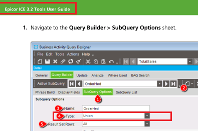

Do you have a copy of the ICE Tools User Guide from Epicor?
There are some good/simple examples that helped me decipher those “understood by Epicor” parts.
