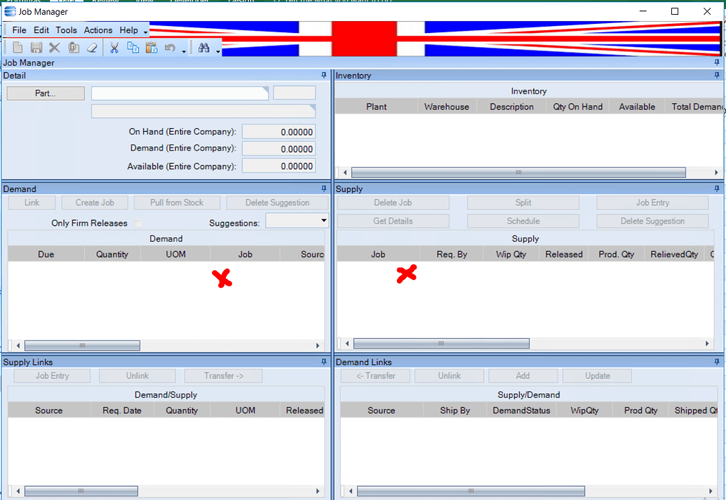

hello, i appreciate this page is quite old but i need similar help adding a column to a grid…
I am using epicor 9.05.701
I would like to add the field JobHead.AnalysisCode to the 2 grids marked with an X in job manager…could anybody give me a complete idiot’s guide on how to do this?
Many thanks.
