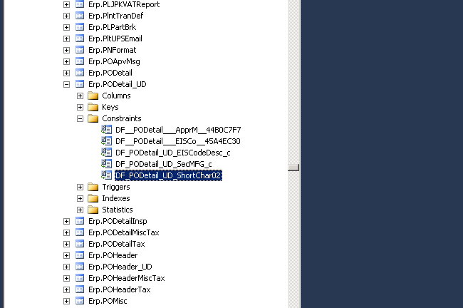

You can visually remove the constraint with the SQL server MGMT tool.
or you can do so in sql.
ALTER TABLE [Erp].[PartPlant_UD] DROP CONSTRAINT DF_PartPlant_UD_GPMReviewComments_c;
If you do everything correctly. You will not need to reimport the data. That is just incase the column gets messed up.
