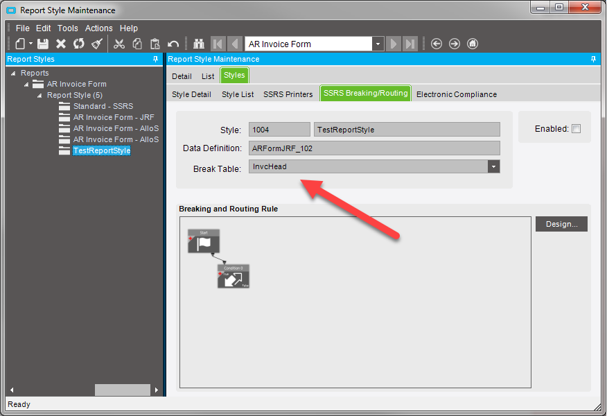

Scenario: Send Individual Invoices to Each Customer
A new report style should be created that is clearly marked for routing
The Break Table is the dataset used for the breaking. Typically this should be a header level table.
For example, using InvcHead on an ARForm style would allow the breaking to occur on each unique invoice.
Within the Design of the BPM, it’s a good idea to create a condition before breaking.
In this case, I’m going check both the “null” and “empty” string conditions for the Customer Email Address to make sure they are neither before proceeding with the break attempt. I also recommended selecting the “Any Rows” condition rather than specific rows (added, updated, modified, etc.) UPDATE: Use contains @ instead of null/empty
Create a Break node and select the column to break on. In this case, I’m breaking on InvoiceNum
Create and configure the Send Email node. In this case, I’m hard coding the “to” as myself and the from should be a spoofed email. Keep in mind this uses the SMTP settings defined in the company. The SMTP Settings must allow for anonymous authentication, so you cannot use the Office 365 SMTP settings.
I also discovered that you must connect the break to the start node and place your condition after. It will fail otherwise.
Interestingly, I needed to have my Conditional Check on CustomerEmailAddress check for "contains" @. It did not work for null or blank.

Created Style, Break table is InvcHead.
First Break on CustNum, then Group By Cust Num
Email Validation checks any row contains @.
The result is a single PDF of all invoices that it identified.
An interesting usage might be to have a group by Report Style that sends a group of invoices that are all over 90 days old, for example.

You cannot change the RDD used by the report style, once it has any break routing added to it.
You can change the actual RDD (just can’t select a different one). So at a minimum, if your Break Routing style uses a built-in RDD, make a copy of it and use the copy for the style’s RDD.

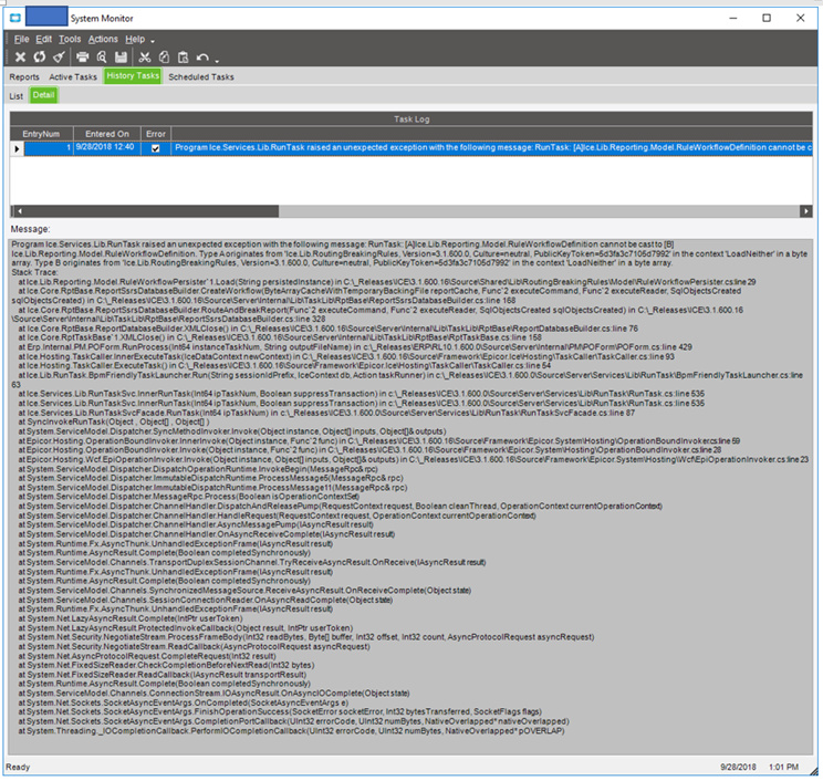

I recycled my AppServer today (I didn’t restart the Task Agent, only the AppServer) and suddenly my Breaking and Routing Rules stopped working and I was getting this error in the System Monitor:

Thankfully I had created a Solution file for my APR Breaking and Routing Rule and once I had it working the way I wanted it to I exported the Solution. (I highly advise this!!!)
I re-imported my APR B&R Solution to restore my B&R Rules/Report Style.
Then it suddenly hit me that my B&R Rules were working before I recycled my AppServer and so I not only Recycled my AppServer again but I restarted my Task Agent and my B&R Rules started working again without error.
Whew, that was a lot to say but I just wanted to share my experience and warn people that these things might happen! :warning:
