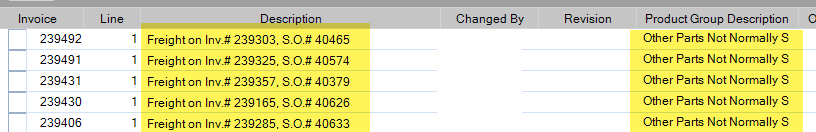

We use a UD field on the AP Invoice line to record the packing slip number pertaining to the AP Freight invoice. This number is typically on the Freight Invoice.
After that it is only a matter of a BAQ to organize the data in any shape or form you like. We have created a dashboard for the user to check freight on past shipments. This helps in future pricing decisions and also checking if duplicate freight invoices.

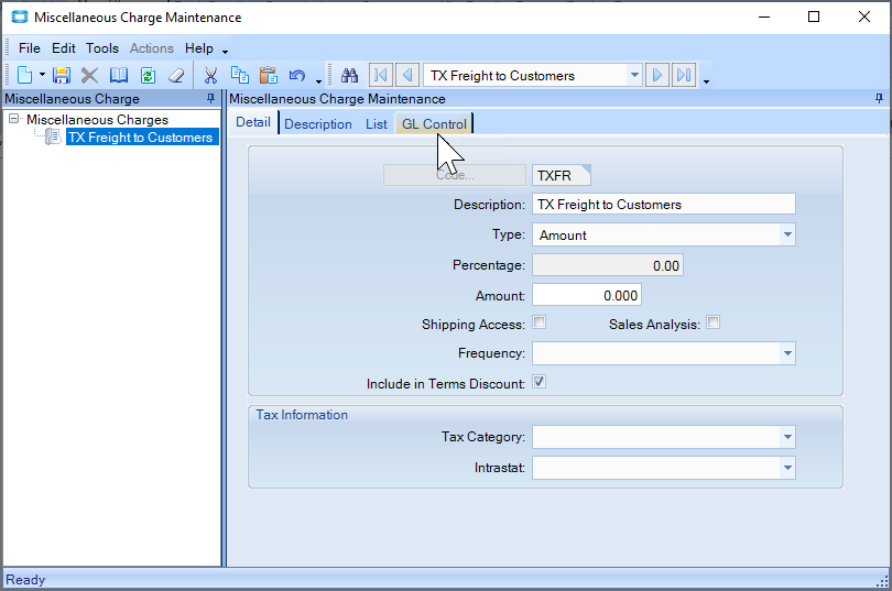

We use miscellaneous charge on the sales order. The misc charge can be tied to GL control.
This post tells about others doing it too ~

If you want a UD field to hit the GL you would have to change the posting rules for the document. You would be better off using Misc Charges. That will hit the GL if a control is set up.

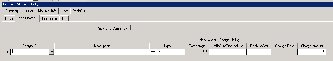

I agree with others that the Misc Charges in Customer Shipment Entry would be the way to go with this.
You simply need to set up Charge Codes (according to Technical Details) in the MiscChrg Master File. This entry should then be printed on the Packing Slip and transferred over to invoice processing.
It’s pretty neat because you can do a dollar amount or a percentage of a dollar amount. It will also charge tax if you flag it to do so.
