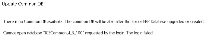

  • When attempting to deploy ran into the issue where IceCommon database has wrong name, ICECommon_4_3_1004_3_100 for example
  • Solved for the purposes of deploying as found elsewhere on this forum, renaming the database
  • Printing doesn’t work.
  • Have tried the “Update Database” command and it says it worked;

Program Ice.Services.Lib.RunTask when executing task 3561200 raised an unexpected exception with the following message: RunTask:
System.TypeLoadException: Could not load type ‘Ice.Tables.ReportStore’ from assembly 'Ice.Data.Model, Version=4.3.100.0, Culture=neutral
Edit: redoing this I’ve ended with a database name ICECommon_4_3_1004_3_100
but it’s looking for
I can rename it and it deploys without error, but will not print

So @SteveFossey there are two views in the Epicor DB which point directly to the Common Db I suspect yours are pointing to the wrong one
I have to look and see which they are this bit me cause we do replication
But look at views in your db two of them are expecting the Common Db with a specific name and I suspect your renaming etc broke em
Found them
See if those views are broken : pointing to somewhere else

@askulte good idea. I did try renaming but I noticed that on my production server, after I installed 2024.1 base for Pilot I got the ICECommon_4_3_100 DB and then when I added the 2024.1.4 update, I got an additional ICECommon_4_3_1004_3_100 database. In this case Pilot works fine, except for the paste-insert bug. Maybe i actually need both and I’ll try copying one to the other.
@josecgomez that might be it. Support had us try running
create view [Ice].[ReportStore]
as
select PrintProgram, Content, ContentHash, Ice.SetReportStoreSystemFlag(PrintProgram) as SystemFlag
from ICECommon_4_3_100.Ice.ReportStore
GO
But maybe I need to do the same for Ice.Fieldhelp
