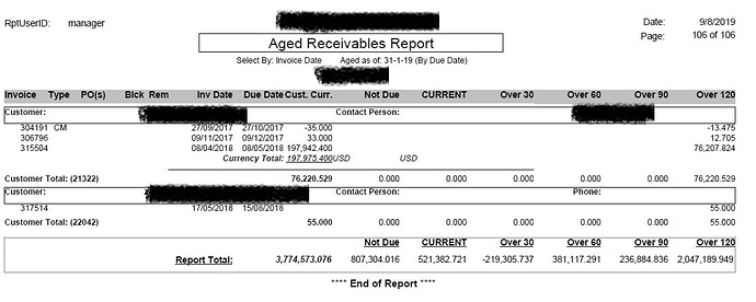

Dear mpeters, We have run the above query but it is providing the wrong values for Future, Current and Over 120 columns .
Result by executing query
AR Aging.xlsx (23.2 KB)
Result by AR Aging Report
