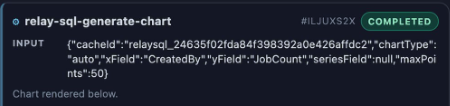

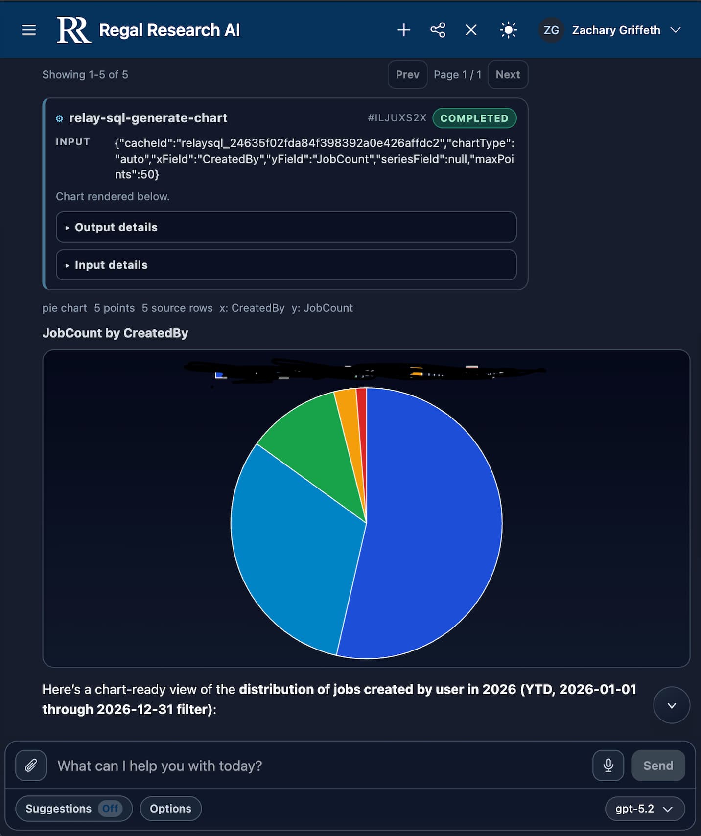

This is easily engineered and is almost our process. The AI only executes a series of tools. It never has to be given the dataset (just schema), it only has to write queries and execute functions.
Note the cache ID
edit: I say almost as we’ve given it a tool to pull this data, something easily removed. Otherwise, the data is funneled to the client for rendering or another tool.

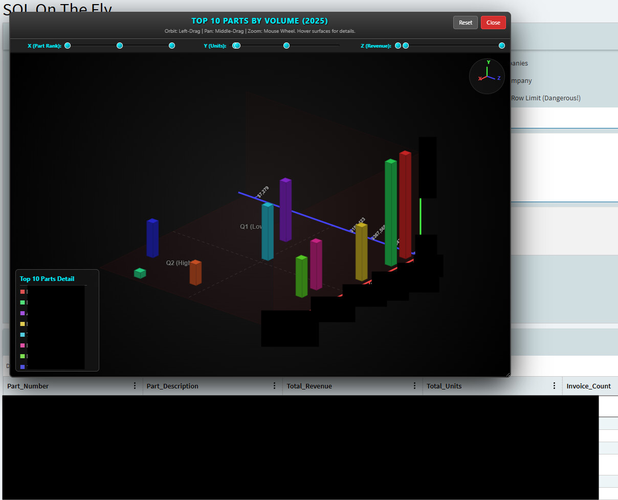

It sounds like we have a very similar setup. How do you handle the chart drawing? I have the AI simultaneously execute two codepaths with a common knowledgebase - a SQL codepath and a schema-aware chart building code path. the sql gets executed on my side, returns the data, then the chart gets displayed on top of the dataset.
Gemini is pretty reliable at producing a 3d rendering engine with dynamically adjusted axes - this chart is fully interactive with 3d pan/tilt/zoom, dynamic tooltips on hover of all ui elements, adjustable axis, orienting HUD. It’s able to generate any number of 3d chart types that you might find in a given BI software. Touch and mouse/kb interactive.
Input Query was: “show me the top 10 parts by sales volume in 2025. graph this on a bar chart”
The data is provided in a grid in Kinetic with the usual sort/filter/copy functionality, and the chart is dynamically overlaid on the dashboard based on the data.
Once the SQL tool is called by the standard chat pipeline, it is handed off to a specialized AI call with its own prompt, tools and execution settings. The result cache and formulated parameters are handed off to chartjs. I have not experimented at all with 3d, but that is super neat. Gemini does do a lot better with 3d visual understanding.
The AI app server hosts the website so that it can be reached from mobile and communicates privately over relay. This allows complete separation of public and private infrastructure.

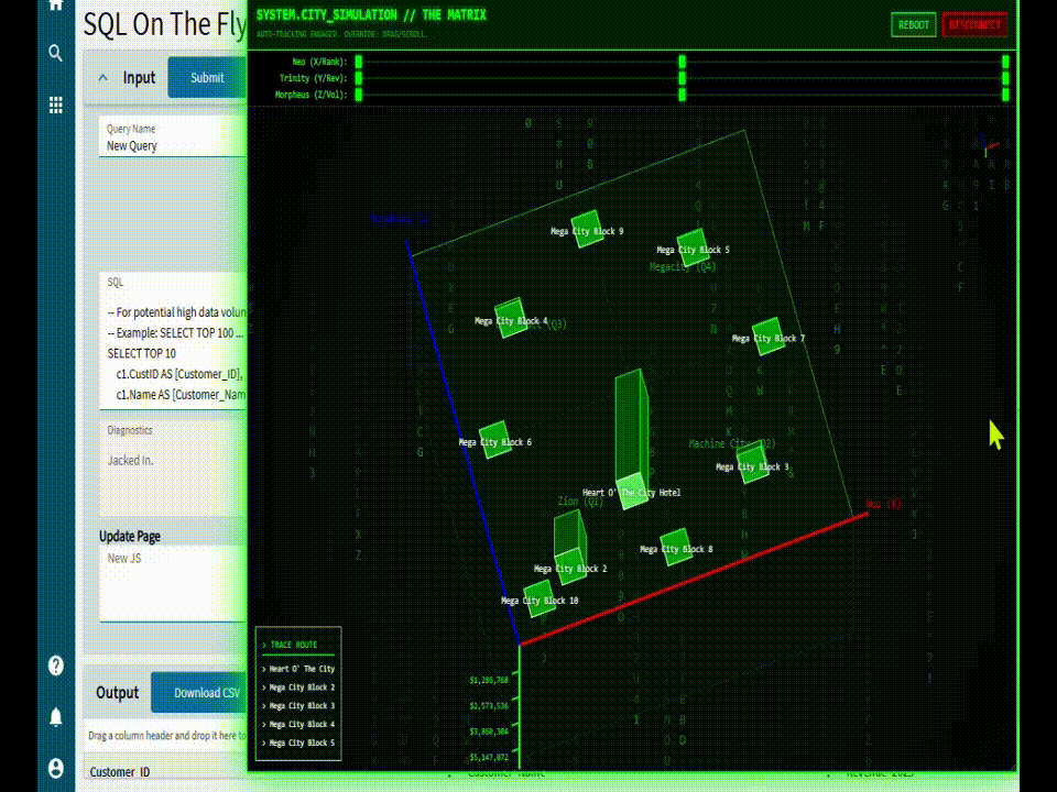

chart the top 10 customers by 2025 revenue in a “the matrix” style simulation taking place in “mega city”. the city should be represented as a bar chart style simulation, with the top customer being the “heart o’ the city” hotel. name the various axis labels after characters from the first 3 movies (we begrudgingly respect the existence of the 4th movie). obfuscate the data in the graph. the viewport should be an automatic animation that circles the heart o’ the city hotel and swoopingly and dramatically visually displays the differences between the bar chart heights as the camera moves around. feature matrix code, the “green” matrix theme colors, and volumetric clouds and rain.
The_Matrix_Mega_City
there should be basic police vehicles drawn parked at the base of the hotel with blue and red sirens. there should be projected simulated lighting from the sirens that lights up the bar charts and the “floor” dynamically.

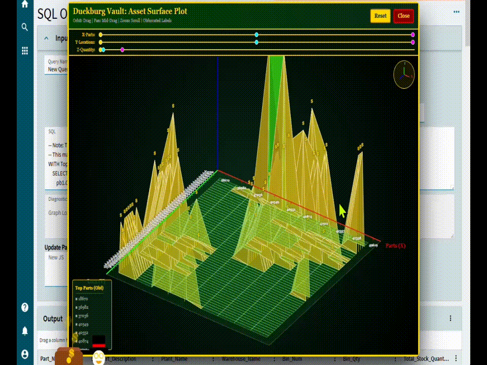

show me the top 10 parts by warehouse stock, their plants, warehouses, bins, and quantities. graph this information on a surface plot. draw an svg animation of dollar signs leaving a wallet in the lower left hand corner of the window, outside of the bounds. theme the ui/ux after scrooge mcduck in duckberg. obfuscate the data labels.

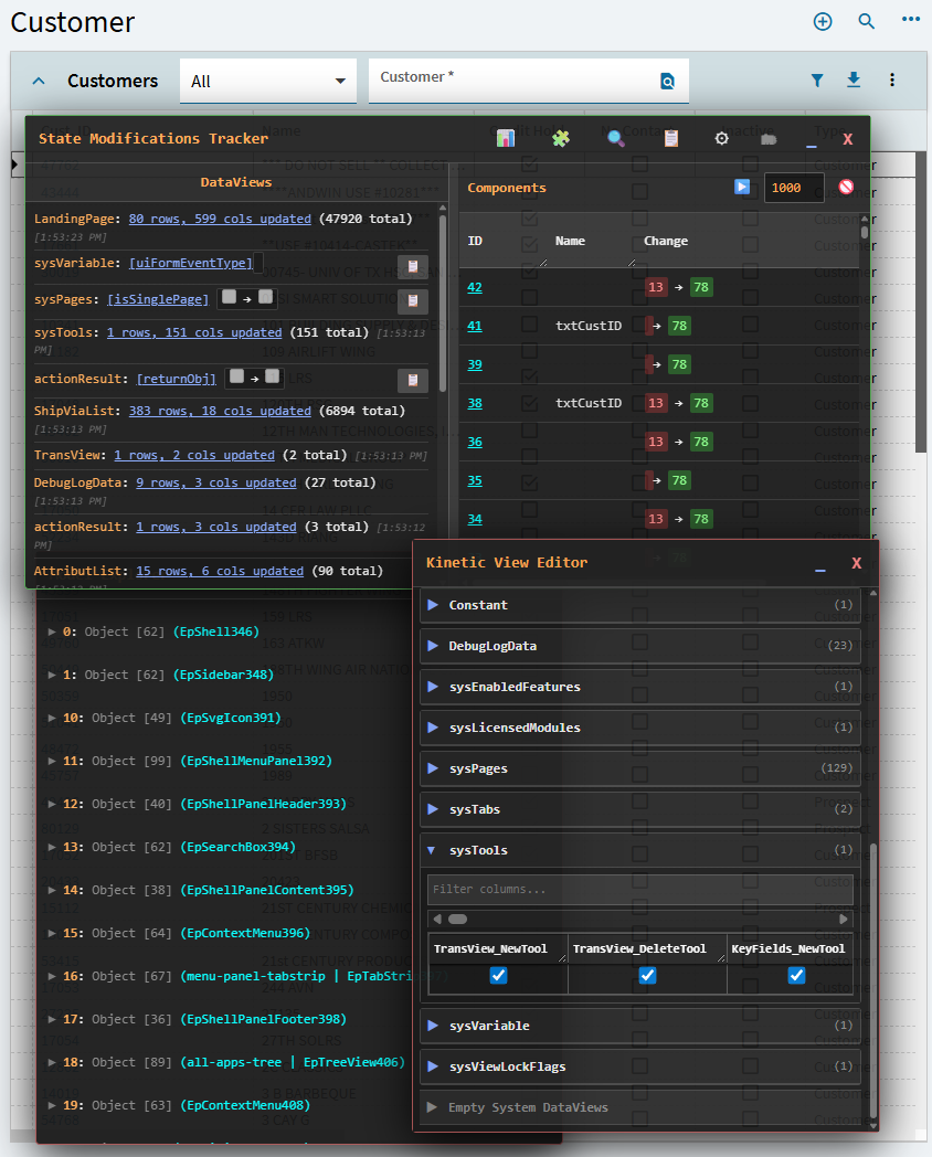

Epicor Kinetic Debugger (this allows you to browse the component model tree, dynamically visualizes dataview state changes and component state changes, and features a read/write dataview and component property editor.
I’ve also created a localStorage editor to edit epicor’s cookies and stuff.
I’ve been sitting here thinking of how I can improve the user experience, not even thinking of my own uses. You are going to motivate me to make a Chromium plugin, assuming that’s what you’re using?
No plugins needed, this is natively served from Kinetic via App Studio :slight_smile: It works on any browser, phone/tablet, refrigerator, etc.
Really? I wasn’t sure there was any avenue for injection… what is your point of entry?
row-update (and a few other places in app studio) allow js expression evaluation.
