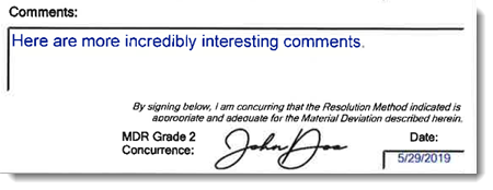

One idea we tried as an internal proof-of-concept to a very specific Epicor customization was to scan handwritten signatures taken from DERs, QA Inspectors, MDRs, etc - and process them as graphic assets (png, jpg, gif). These asset files were then placed in a separate “Signatures” folder right next to the “Reports” folder on our SSRS report server.
We then placed Epicor user accounts into very specific security groups based on their authorized qualifications as a DER, QA Inspector, or MDR. Our Epicor customization was arranged so that access to the form module itself, or controls within the form module, were accessible only to those accounts in certain security groups – which included “signature buttons”. The idea was fairly simple: if I log into Epicor and I am in a particular security group that has permissions for a signature button, then I can see that button on the form module (which means I am authorized to sign-off for a process on that form). If not, I don’t even see that button, or signature field (the button merely places the signed-in user’s name as a session variable into the field).
When I’m ready to print the internal document from this form module, the SSRS report translates the user sign-off value into the physical graphic file that resides within the “Signatures” folder on the SSRS report server:
Example 1
Example 2
Notice that the same “John Doe” signature example above can be reproduced anywhere that specific user had been authorized to “sign” – i.e. “click on the signature button”.
