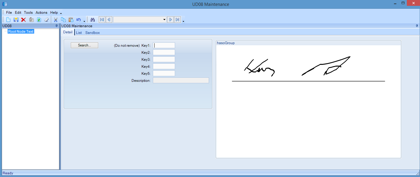

https://www.infragistics.com/products/windows-forms/data-entry-and-display/ink-provider ( I wonder if you can just use the Ink Panel )
or CEFSharp and JavaScript, reading back the Base64:
Can be done with Customization and again I am sure there are libraries out there that didn’t exist in 2012 :slight_smile:

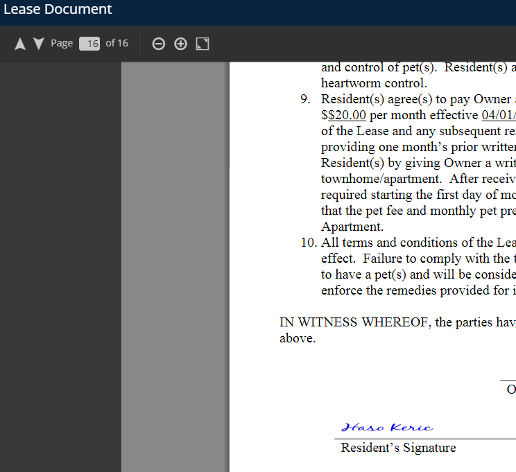

The Question is it doesnt even have to be a PAD it could be “By Clicking and Entering your Name Here” you are ‘“Signing’”. Store the Name in a UD Field then on your ARinvoice SSRS .rdl you have a SignatureTextBox with “Comic Sans” font :slight_smile: and voila!
Take the “Signature Pad” out and use a Script Font and Just a Text Box - with a checkbox that they Agree. Even Record the IP and Date/Time.
I just had to E-Renew my Lease… They had an option to Pick a Font “CREATE Signature” and then it just did it… If Apartment Complexes can Legally hold you accountable by using a font; so can you…
2019-03-15_1238
PS: My wife had her own login and once I completed my Signing - she logged in and did hers. (In case you need multiple signatures).

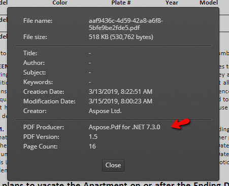

It looks like this is what they are using:
2019-03-15_1247

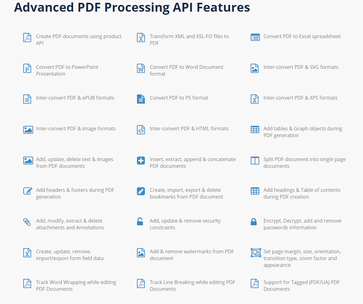

Check out .NET PDF API - Create, Load, Modify and Convert Documents | Aspose.PDF
In addition they use
So Yardi might be the one using ASPOSE with their “yardi ysignature” component.
