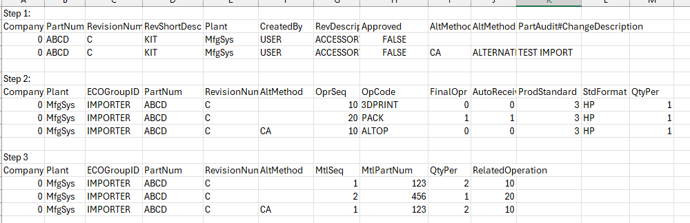

I am seeing an issue when I try to import Alt Revisions. It seems as though when I use DMT to create alt revisions (I have a few hundred), it copies the BOO and BOM of the parent revision. This is undesirable as out alt methods nearly always vary in terms of operation (number of ops and opcode). The parent revisions already exist.
Here is a screenshot of my DMT file:
That is default functionality in Epicor. When you create an AltMethod, it automatically copies the entire MOM from the parent, which then you would modify to suit your requirements.
You’d need to have 3 different DMT loads… first one on PartRev to create the alt methods, then one each for Bill of Operations and Bill of Materials to modify those records.
Sounds like a HUGE pain in the butt, but still better than using Engineering Workbench and doing it all manually.
Ah, I think I see now. So I should have imported Alt Methods the same time as I import the standard methods?
And essential, this workflow would look like:
Correct.
The only caveat there would be if your Alt Method has FEWER operations or materials than the Parent Method, you’d need to delete those “extra” items separately.
Say your Parent Method has 5 material records, MtlSeq 10-50. If your Alt Method only has 4 material records, and you modify MtlSeq 10-40, MtlSeq 50 won’t go away all by itself.

Just so I understand - if I import the above BOO and BOM files, since the Alt Method has fewer ops and materials, I will see the “extra” things from the parent Method in this import?
In other words, there is no way to import Alt Method truly “separately” from parent method?
Correct.

That is too bad, lol. Because if the alt method is a change to an operation with materials assigned to it, do I need to delete all the materials underneath to change the top operation?
Or can I DMT an updated operation code for that one op? And will that work if the parent op is subcontract Operation, but alternate operation is in-house?
Sorry for all the questions - I understand Alt Methods from UI, but trying to mass DMT correctly is very confusing…
Techincally, there is no way to CREATE Atl Methods truly separately. Once they’re created they go their separate ways… but I’d be sure to test the living daylights out of that statement before I present it as gospel.
You can probably MODIFY an operation that has materials related to it, but I strongly doubt you can DELETE it. Generally speaking, it’s best to upload the BOO first for precisely that reason… but if the BOO already exists and it s SHORTER or THE SAME as the parent BOO, you might want to upload the BOM modifications first. If the new BOO is LONGER and there might be materials related to ops that don’t exist yet, that will be a problem.
Using any “automation” tool removes some level of choice. It has to. I think you need to go into Engineering Workbench and manually go through the steps of what you want to do, and make notes on anything that happens that you don’t want to happen SO you can design your eventual automated process to account for those things.
DMT is not magic. It uses the Epicor Business Objects (almost) exactly the same way that a user would if they were doing that process manually… so it’s usually best to find out what is really supposed to happen.
