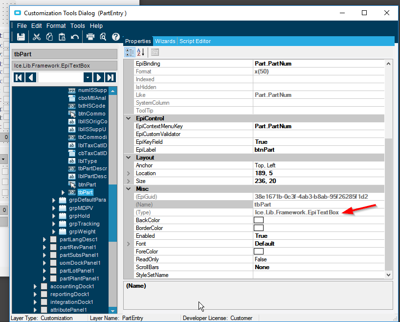

So the field type you can find when you click on the control and look in the properties, it should tell you what type of editor it is, that should tell you what you need to put into your control to get a hold of it. See what those boxes are there, and you’ll know how to set them up.
Also I’m just wondering if the use of the generic “Control” is messing you up. Generally I set up the variable first.
EpiNumericEditor YourNameHere;
Then link the control like this
YourNameHere = (EpiNumericEditor)csm.GetNativeControlReference("GUID");
So if you keep with that convention, replace “control” with “EpiNumericEditor”, it would make more sense to me.

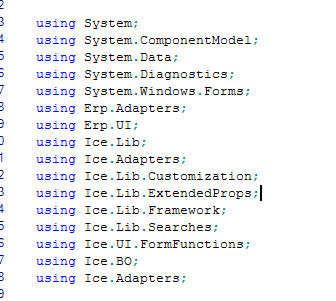

I’m planning to clean it all up once I get it working, but I’m already referencing theIce.Lib.Framework
As well as using this:
With the same error as above
If that was the case your error shouldn’t say “control” it should say EpiNumericEditor. You must have something duplicated.
(335) - ‘System.Windows.Forms.Control’
I think that was it! All is working now, minus the duplicate text box!
