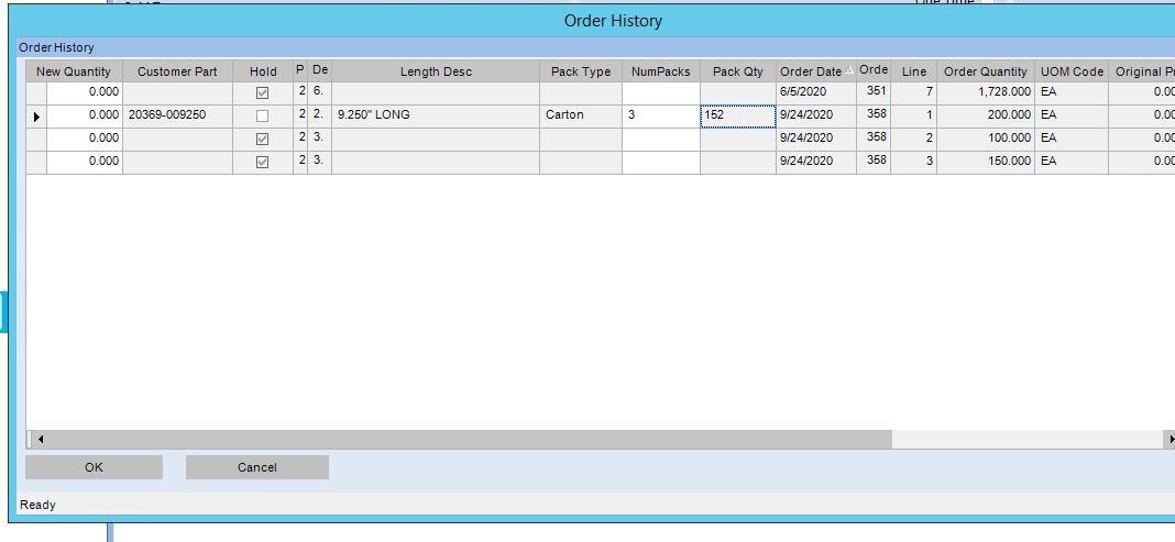

This customization adds a few columns from a BAQ to the Standard Data view for Sales Order > Build Order from history. I am now trying to add a new input field (NumPacks) such that they can change that value, and it will do the math and fill in the standard Epicor Value (NewQty). I started by adding a field to my BAQ that returns a Zero, and making it ReadOnly False, seems fine.
My goal, is that IF someone changes that field, it will do the math multiplying NumPacks * Part_Number05 and replace the proposed value for NewQty.

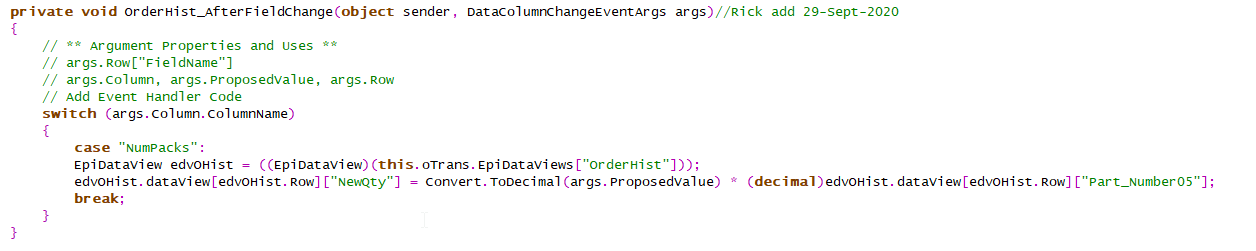

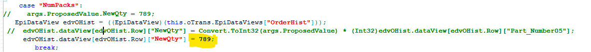

private void OrderHist_AfterFieldChange(object sender, DataColumnChangeEventArgs args)//Rick add 29-Sept-2020
// args.Row["FieldName"]
// args.Column, args.ProposedValue, args.Row
// Add Event Handler Code
switch (args.Column.ColumnName)
case "NumPacks":
// args.ProposedValue.NewQty = 789; - //I WANT TO SET 'NewQty' which is a native field in Epicor, to 'NumPacks * Part_Number05'
break;
