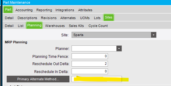

Looking into alternate methods. I’ve got a base part with Revision 1, I’ve set up an alternate method for part 1 (1-A). The base rev has operation X, and the alt rev has operation Y. When MRP runs for the selected part, I want it to pull in the alternate method to the job, but currently it’s pulling in the base rev.
Am I missing something here?
Part Plant - Primary Alternate Rev I think will get you wher you want.
Try putting your alternate method here, then re-run MRP.
Thank you very much. This got me exactly what I was looking for.
