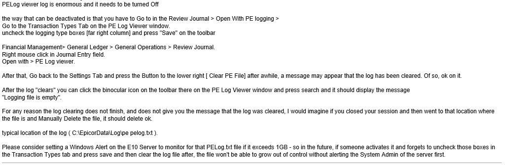

a couple of weeks previously the client had engaged Epicor technical support to troubleshoot a mass printing. During that session, the technician had enabled the Posting Engine Logging on the Live environment…but failed to turn it off after completing the session.
As days went by, the PELog.txt file became “enormous” and too big to load, and would crash the Application pool each time the posting engine tried to access the file.
For reference the PElog.txt is typically located here: \EpicorData<Company>\PE\Pelog.txt
Once we confirmed the file location and size - > 1GB we deleted the file and processing resumed normally - no recurrence of the error. There was much rejoicing!!!
An Epicor direct consultant help dig up the instructions for disabling this logging - posted below for reference should anyone else stumble across this thread due to a similar error message.
