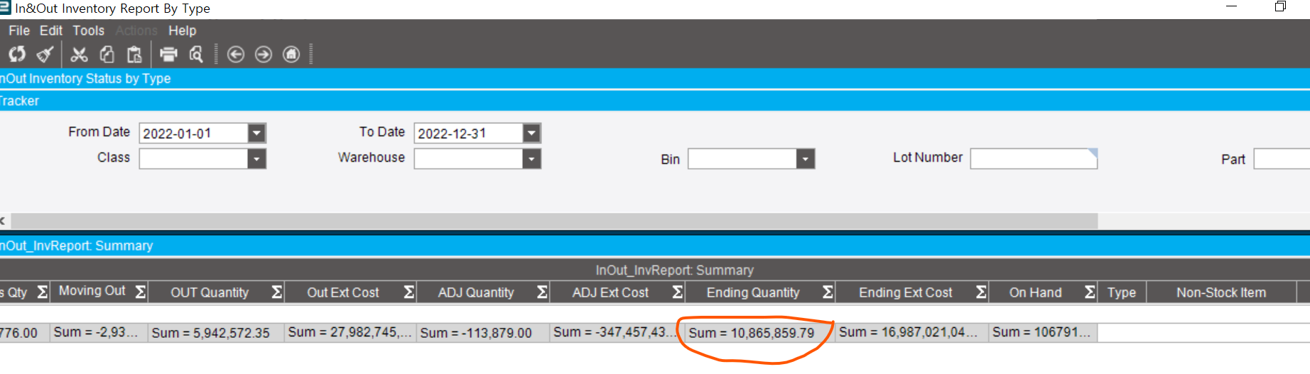

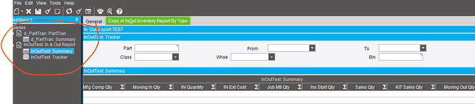

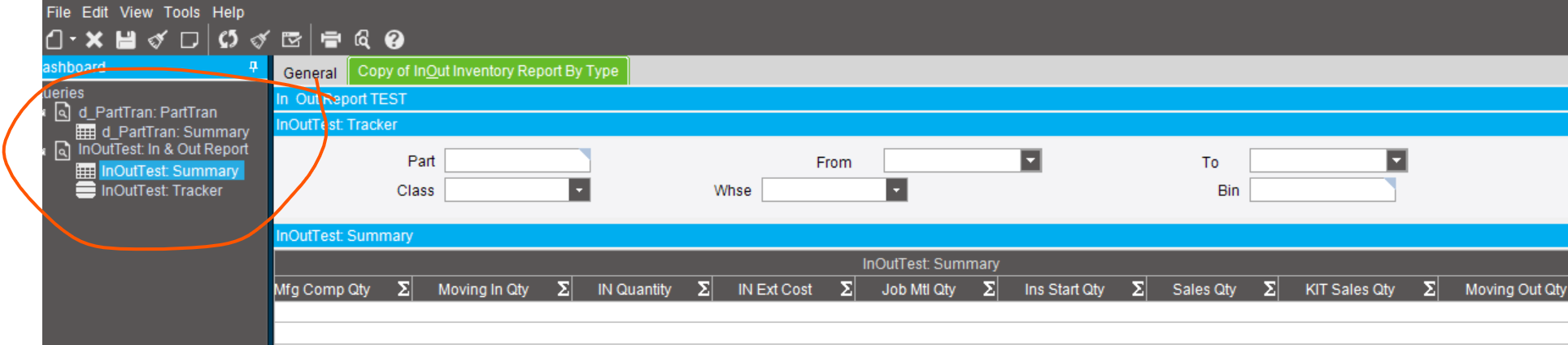

I created a new menu using BAQ and Dashboard. I created a report showing the quantity of In&Out/Ending inventory for each type for a specific period of time.
Strangely, different data appears for each user.

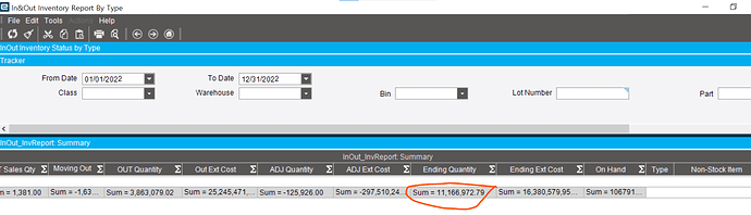

As you can see in the screenshot below, when searching under the same search conditions, 10,865~ appears when I searched, and 11,166~ appears when other users search.
Can different data appear for each user like this? Why is this issue occurring?

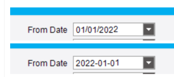

I don’t know why the date format is different for each user.
Is it possible to set the date format for each user? Would a different date format affect this issue?

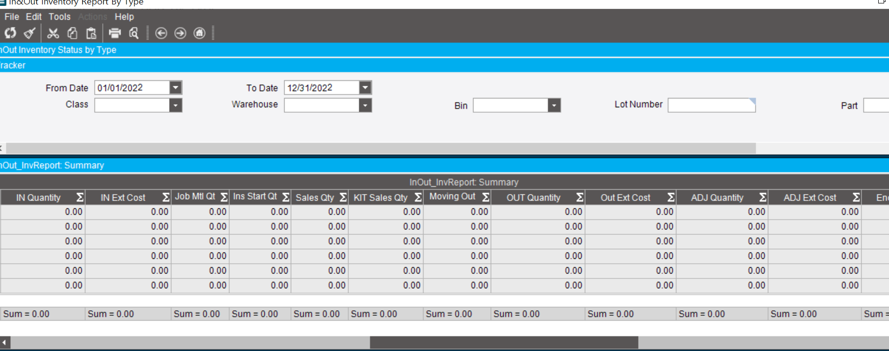

Today, another user complains that no data appears at all.
It’s the same menu, but I don’t understand why different data appears for each user.

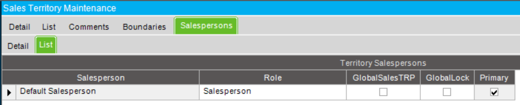

if your baq includes sales data, perhaps you can try looking at sales territory settings, check if the user is assigned to any salesperson, and then check the relevant territory they are assigned to.
try removing them and see if your BAQ can return any result.
The only thing I’m suspicious about is the date format. Is this date format a personal setting? What is the issue that different date formats are displayed for each user even though it is the same menu?
When I inquire, the same data as other inventory reports appear, but when others inquire, different data appear. Everyone’s data is different for everyone.
It doesn’t seem to be a date format issue. Users with the same date format also got different data. Even, every user gets different data.

The only time I’ve seen similar is when looking up sales data. If all sales orders are done through the one workforce, make sure that all users are set up as authorised users of it.
We have about 100 users, and I checked about 40 of them to see what numbers appear in this report. And all 40 people had different numbers. Maybe if I check all 100 people, all 100 people will be different.
When it comes to sales data, I think that several people with the same settings should get the same number.
Can anyone tell me what I need to do to make the date format the same for each individual?
