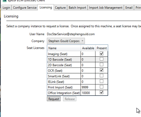

So we bought (or are buying) the 2D license so that we can use QR codes in ECM and skip IDC. ECM’s model is not AI, it’s literally “Look right here” but that’s a better fit for this model because we can either set a region, or have it read all of the barcodes and check against a rigid format standard to decide if whatever barcode it finds should be used for categorization.

We had a stuck license issue with ECM, so I just started with IDC to get something going instead of waiting. Then we went with 2d barcodes, and again licensing, which we are fixing.
