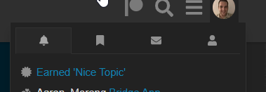

Seems to me someone wants to take over the top of the Nice Topic leader board! :wink: :joy:
shhhhhhhhhhhh don’t give away my secrets, I’m trying to compete with @timshuwy :joy::joy:
Hey… you got another badge… not fair… hahaha :rofl:
