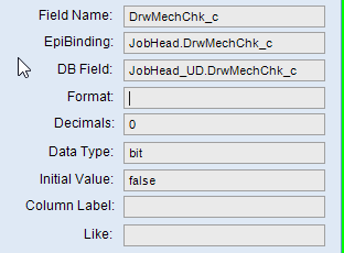

I created a few UD fields in JobHead table that are boolean. They are represented by a check box in Job Entry Form.

JobHead_UD.DrwMechChk_c = value I need check for my logic

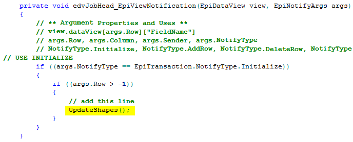

private void edvJobHead_EpiViewNotification(EpiDataView view, EpiNotifyArgs args)
// view.dataView[args.Row][“FieldName”]
// args.Row, args.Column, args.Sender, args.NotifyType
// NotifyType.Initialize, NotifyType.AddRow, NotifyType.DeleteRow, NotifyType.InitLastView, NotifyType.InitAndResetTreeNodes
if ((args.NotifyType == EpiTransaction.NotifyType.AddRow))
if ((args.Row > -1))

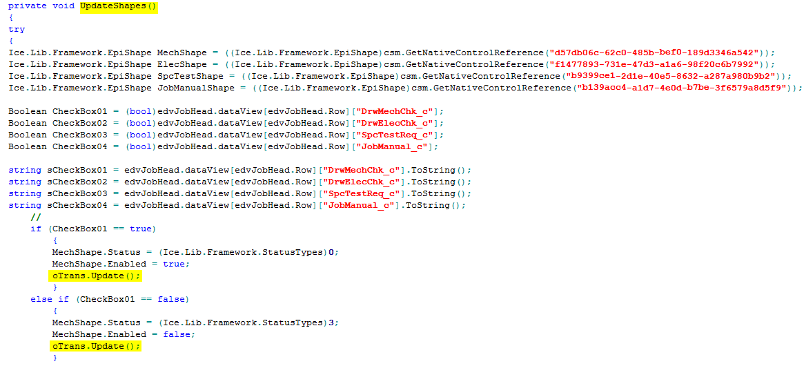

		Ice.Lib.Framework.EpiShape MechShape = ((Ice.Lib.Framework.EpiShape)csm.GetNativeControlReference("0901396e-f1ac-4960-b4a1-47b8a2272727"));
		EpiDataView edvMech = (EpiDataView)(oTrans.EpiDataViews["JobHead"]);
		Boolean MechBool = (bool)edvMech.dataView[edvMech.Row]["DrwMechChk_c"];
			if (!(MechBool))
			MechShape.Status = (Ice.Lib.Framework.StatusTypes)0;
			else
			MechShape.Status = (Ice.Lib.Framework.StatusTypes)3;
The wizard for the Notification event defaults the “if” statement to epiTransction.NotifyType.AddRow. You probably need to change the AddRow to Initialize,

Do you think it would be ok to use oTrans.Update() in the EpiNotification event or should I assign a “On Field Change” event? Looks like it is working fine with this code.
I’ll have to check the tracing to see if its saving upon loading or something.

I want database change when the box is checked, oTransUpdate() performs an automatic save after checking. I have it working and deployed now though.
Just wasn’t sure which event I should be using for Save-After-Click.
