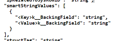

Looking at the swagger, one of the parameters needed is:
After a little digging, I’ve worked out I need to add areference to Erp.Shared.Lib.Configurator and use a list with a PCKeyValuePair as this parameter. I can’t find what information this key/value is looking for though. I’m guessing it’s the textbox name and value, but I can’t get it to work.

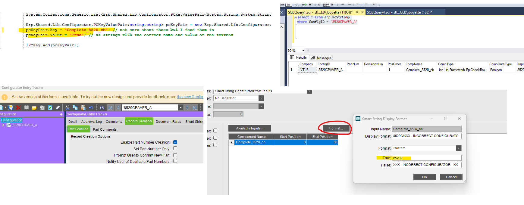

Hi RJM, I was running into the same issue and stumbled across your post. your code helped me figure out how to get the smart string.
I was able to get the method to work with the correct values in the KeyValue Pair.
Enter in the Input and the Value from the Record Creation screen on the configuration. can find this data in the PcStrComp table in the dataset
