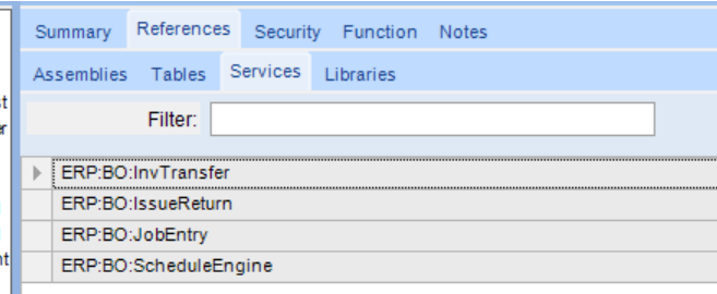

First add the service references to the function library

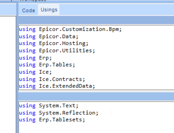

Add a using for System.Reflection
