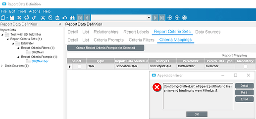

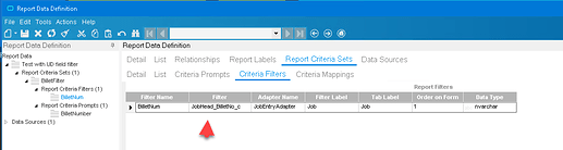

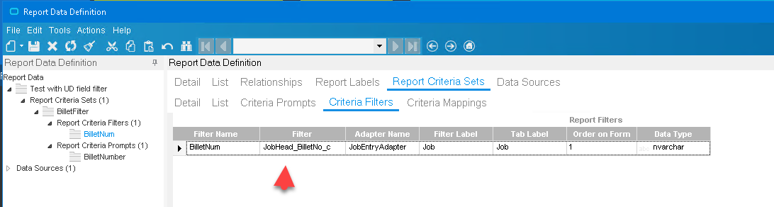

Tried entering in the adapter manually on testing it threw errors. I’ll document my example more clearly so you can see what I’m doing, I did try this on a BAQ report and got the same result.
It’s for dynamic values which so that appears to be the route. Something that should not be so complicated just did. :frowning:
@DaveOlender
So it appears that if you enter in the the field into the filter the filter is not recognized, you get an error on previewing the submission form, and in actual fact if you just enter in any nonsense in there you get the same error.
