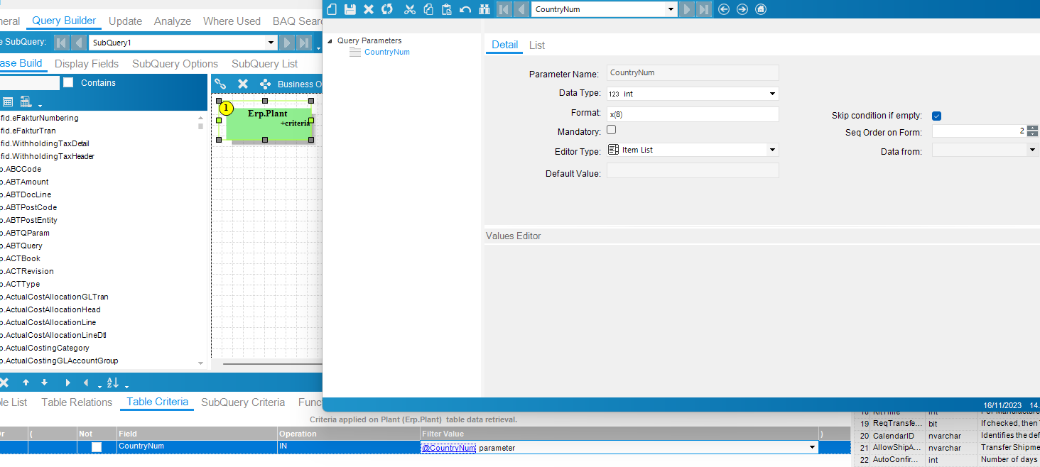

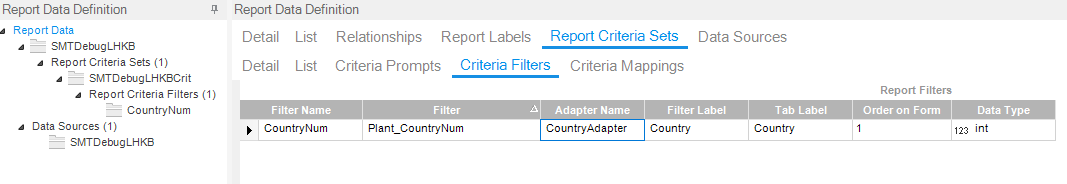

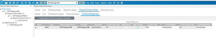

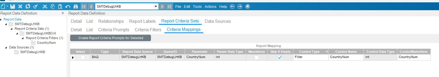

I have RDD using BAQ Data Source. I try to use Criteria filters.

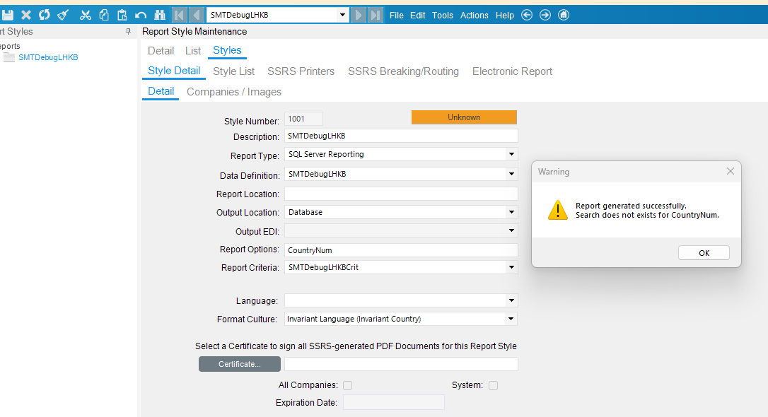

but when try to generate kinetic form in report style ,
it show a warning message as shown below. after the submission form launch and i try to click the button in filter area, it won’t show any data.
the other thing is, when i try to “preview submission form” in screen RDD, it shows a different RDD , it never show my selected RDD.

my goal is to have a filter which have more than one selection.
I have followed this step as well. Any suggestions on how to filter a dynamic report? - #26 by Dragos
