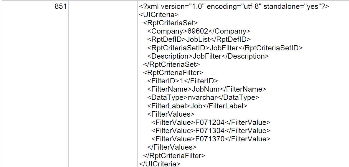

So from what i have found, the filter list is in a reportparameter called UserCriteria which is a big XML paragraph that contains Tags for the Filter list.

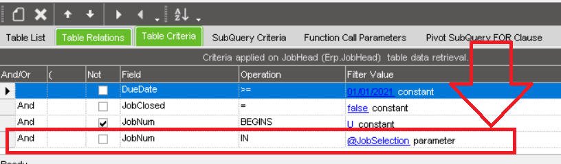

Update - Now that i have been told officially by Epicor Support that we cannot filter using a Dynamic Criteria Report (we need a new name for this - like “Epicor Report” ) - Here is how to do it:

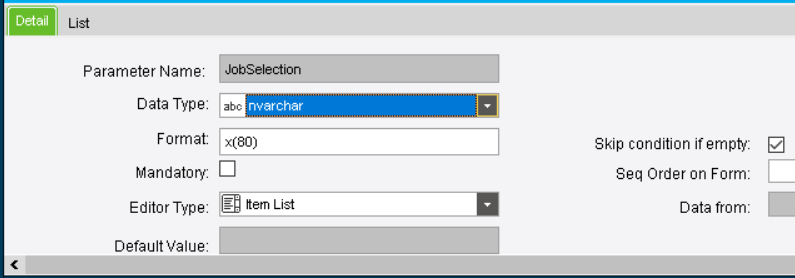

  1. Add a Parameter to your BAQ and assign it as a “Item List”.
  2. Add a table Criteria that uses the “IN” qualifier and uses the added Parameter:

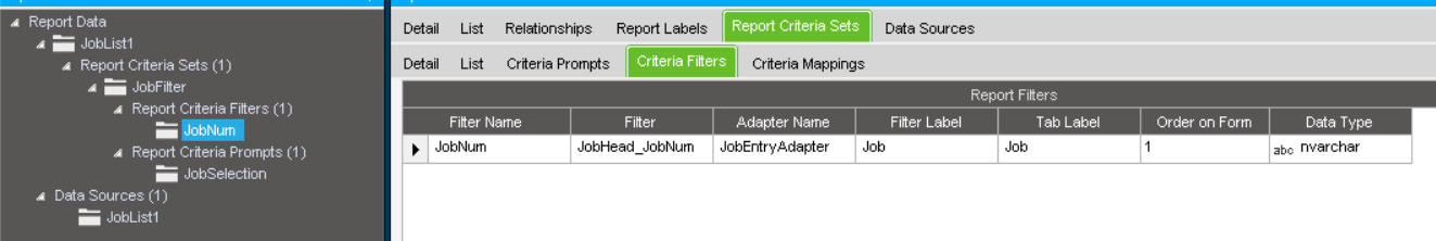

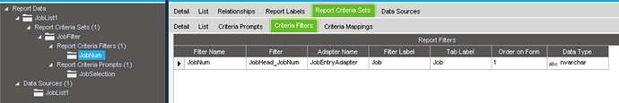

  3. Add a filter to your Report Data Definition.

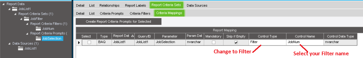

  4. Add a Report Criterial Prompt - Select the prompt and press the “Create Report Criteria Prompts …” then change the Control Type to “Filter” and Change the Control name to the name of the filter we created in step 3.
Your report will now be filtered by the list.

So your form has:
  1. A Filter sheet where you select multiple records
  2. On the main sheet, a text box that shows the key values of the rows on the filter page.
Is that textbox on the main sheet editable? Like you could actually type a list in like:
12345-1-1, 12350-1-1, 12350-1-2
It seems like the filter sheet isn’t really used by the RDD, but rather it just populates the Criteria Prompt - which is used in the SQL query’s IN(...) condition of the WHERE clause.
