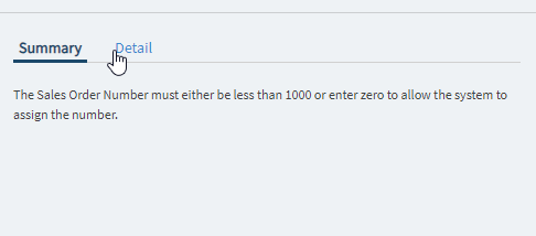

Not here (Kinetic SaaS). I get an error that the Order num must either be less than 60000 (this is where we started numbering in Epicor) or enter zero to allow the system to assign the number.

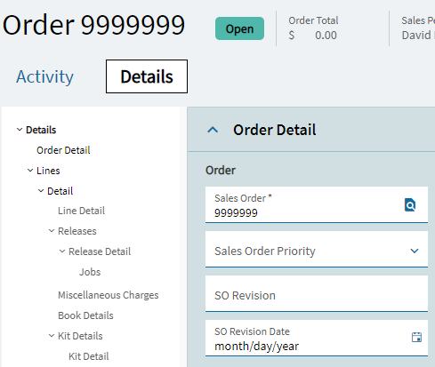

In my test environment… I set the value to ZERO. I was then able to enter a sales order at whatever value I wanted:

Scary thing is, I set my number back to 60000 and instead of it giving me the next available number after 60000… my next sales order saved at 10,000,000 (one value up from my last order of 9,999,999).
I then deleted orders 9,999,999 & 10,000,000 and then created a new order and it still gave me 10,000,001 as my next order.
So, it stored that highest value somewhere and that’s my new counter!!
