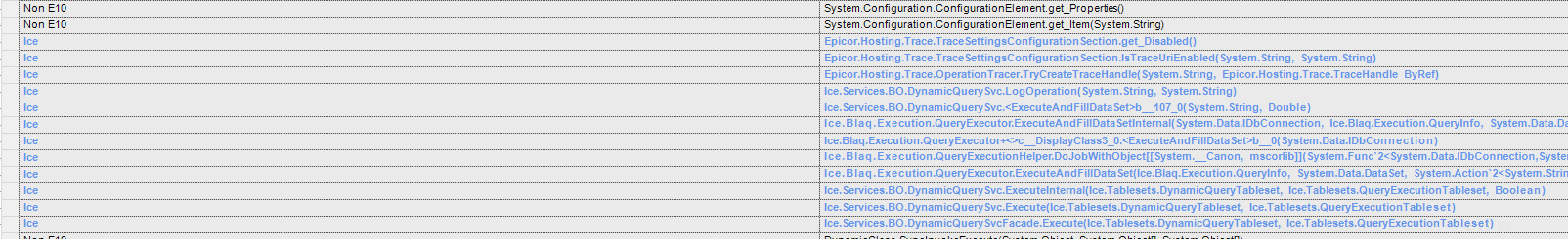

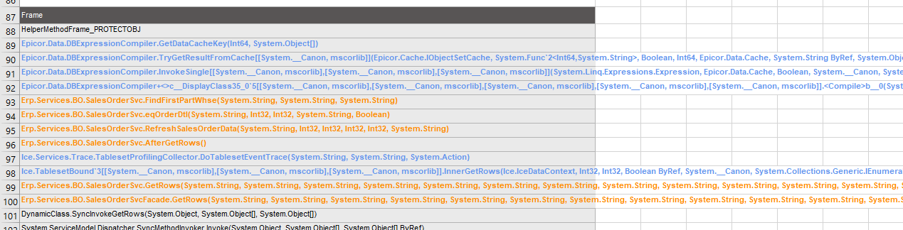

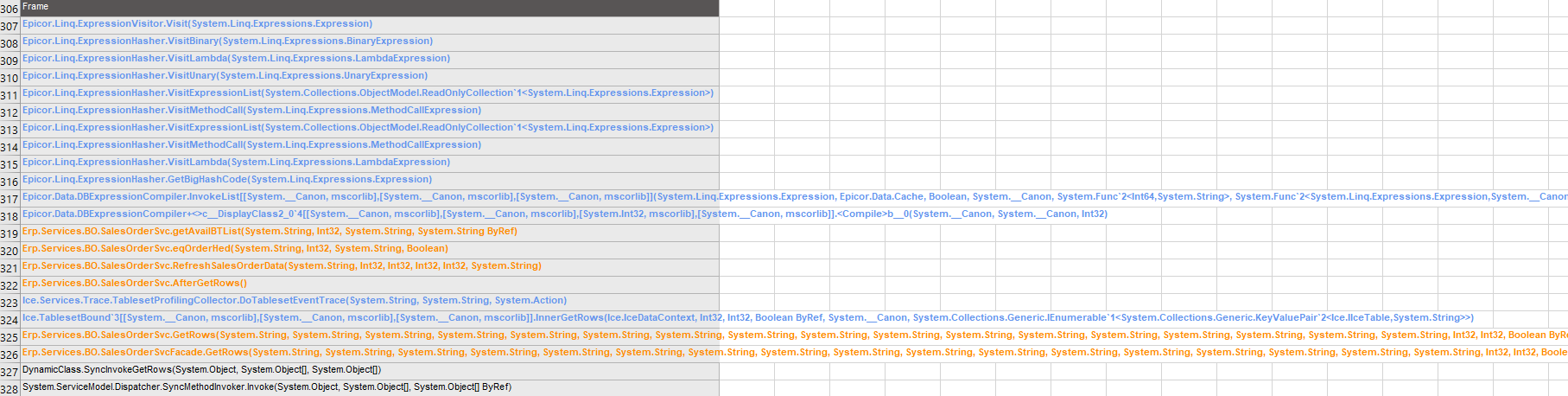

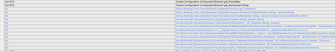

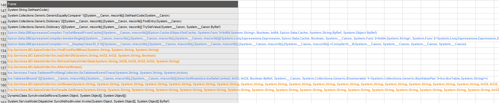

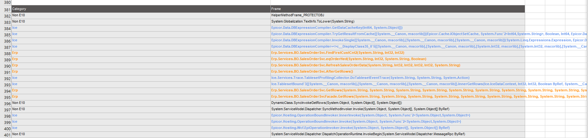

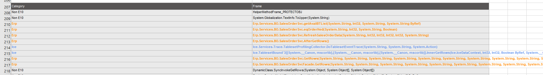

I am investigating high CPU usage on the app server and when I did a live memory inspection I saw these Svc’s being called and consuming the most amount of memory.
Is there any possible way to see all the places they can be called from?
See attached pictures with orange text. If anyone can tell me what process could be running that calls these I would be more than thankful.
I also saw this same query being executed over and over and over on orderhed for different orders… so if anyone has ANY idea what could be calling this, that would help me out so much:

SalesOrder.GetRows could easily just be the Epicor client itself.

If it was a query though it would look like this in stack trace

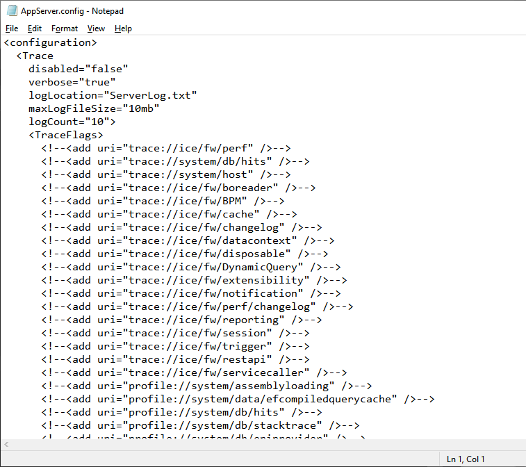

I would go to your Server folder and open up AppServer.config and enable more tracing/profiling options:
It doesn’t require a IIS reset, it is instantly turned on/off. Then monitor your ServerLog .txt files for more information, also the PDT tool can parse several of these and display them, if you get Notepad confused.
You can only enable them via Notepad, the Admin Console doesn’t have UI options for many of these.
I would start there, enable more diagnostics.
If it was a baq though scott I would see the BAQDynamicQuery object being called in stack trace, wouldn’t I?

Haso, any downside in performance if I enable these?
Of course, but you enable a few at a time and don’t enable all - for a period of time… I mean we have several always enabled in production.
Try
trace://ice/fw/servicecaller
trace://ice/fw/restapi
profile://ice/fw/tableset
I guess to me I’m asking which specific flags would make the most sense.
I’ll dig up the sysadmin tech ref guide and see if they address what each of these flags are doing.
See which one gives you enough info to figure out the origins… For example if you enable:
You might find out its a REST Call causing it. :slight_smile: Try a few.
