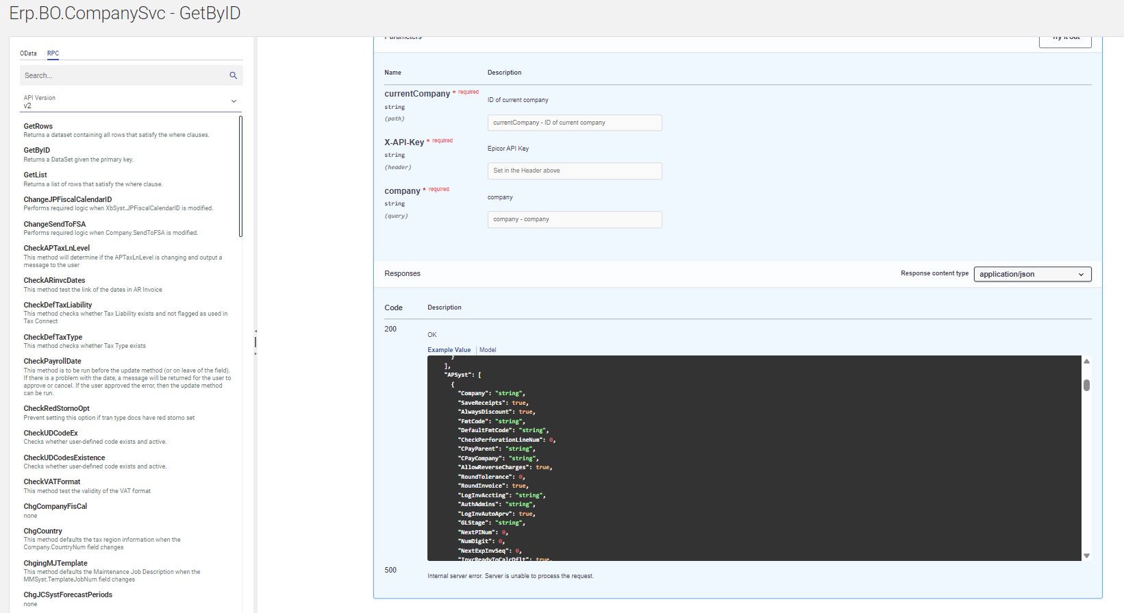

This is also a case where REST comes in handy.
The CompanySvc.GetByID returns all the related Syst table entries for each module.
Paste the JSON and compare in VSCode.
