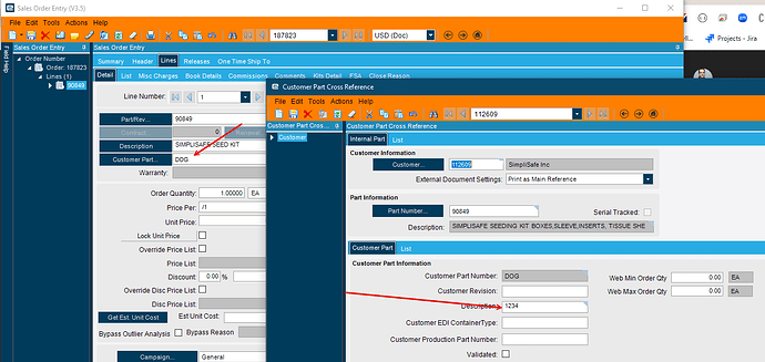

Not sure who is aware of this little feature, but when entering a Sales Order line if you enter a Customer Part Number, Epicor will automatically create the cross reference to your internal part number. Pretty nifty feature, but you cannot enter a Customer Part Number Description, it just takes your internal part number description.

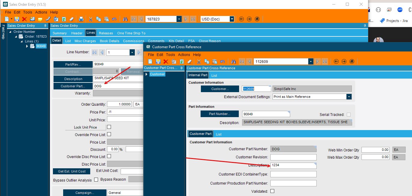

I traced the transaction. I entered the Customer Part Number and tabbed off. Checked the Xref and it was not created yet. Went back and clicked save. Checked the Xref and it was there!
I went through the trace and there was nothing that appeared to create the record. Network tab did not have anything other than the MasterUpdate.
So, how does it get created? Anyone know? I am guessing it is a db trigger or something but do not know how to track it down.

I also recently came across this behavior and also discovered that if my customer part has a different description from our part number, that changing the customer part in Sales Order Entry updates the part description to the description entered for the Customer Part.
I could just write my own event in app studio, but I would rather piggy back off of what epicor does instead.

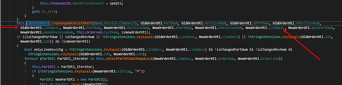

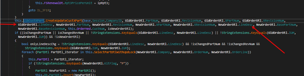

Its a Data Write Trigger on OrderDtl. So it wo’nt be easy to catch.
Um, could you dumb that down? :laughing:
Or expand the explanation?
It is the equivalent of a Databse Trigger. There is a piece of logic that says
IF you are writing to the OrderDtl table check if an XPartNum exists, if it doesn’t lets create it or update it
It is essentially an In-Tran Data Directive (that you can’t see)

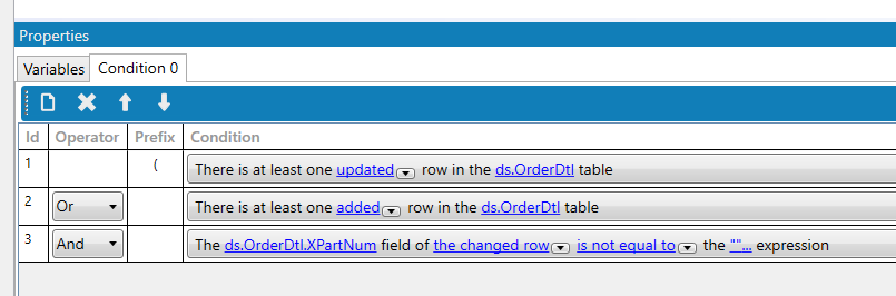

Pre Processing Bpm on Order.MasterUpdate
Condition:
Custom Code Widget:
var orderDtl = this.ds.OrderDtl.Where(r=>r.Added()||r.Updated()).FirstOrDefault();
//Checks to see if this is a new CustXRef and  if it is you can store a special Key in the ErpContext which can then be read all the way down at the Trigger / Data Directive.
if(!(from xC in Db.CustXPrt where xC.Company == orderDtl.Company && xC.PartNum == orderDtl.PartNum && xC.XPartNum == orderDtl.XPartNum select 1).Any())
  if(Erp.Internal.Lib.ErpCallContext.ContainsKey("MONKEY"))
    Erp.Internal.Lib.ErpCallContext.RemoveValue("MONKEY");
  Erp.Internal.Lib.ErpCallContext.Add("MONKEY","1234"); // Here you can store the description you want to use on the other side. Pull it from CallContext or a UD field...
