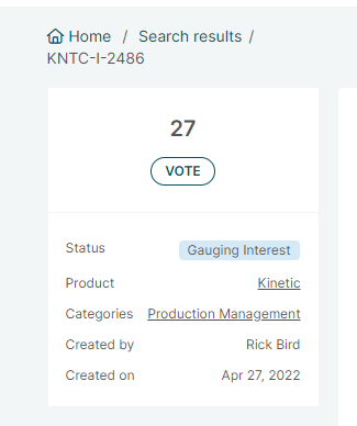

Looks like this one should be changed to delivered though, eh @timshuwy ?
https://epicor-manufacturing.ideas.aha.io/ideas/KNTC-I-2486
The Epicor Idea is still in “Gauging Interest” and has been open for 2 years. There is no indication in this Idea that it was approved. I would have expected to see this on an Upgrade Change List…unless I missed it.
Yeah, you’re right. I thought it was approved. Then looking back it’s not. I do remember it being requested though.
so, yes… this idea was out there for quite a while, and garnered a bunch of votes. Upon looking at it, we agreed that this was the original intent of how the software should have worked, and it does cause challenges when misused.
We turned it into a STORY as part of the UI/UX enhancement EPIC for Kinetic 2023.2, and it was delivered as part of 2023.2.
I just marked it as delivered (I am a little behind on updating delivered ideas).
