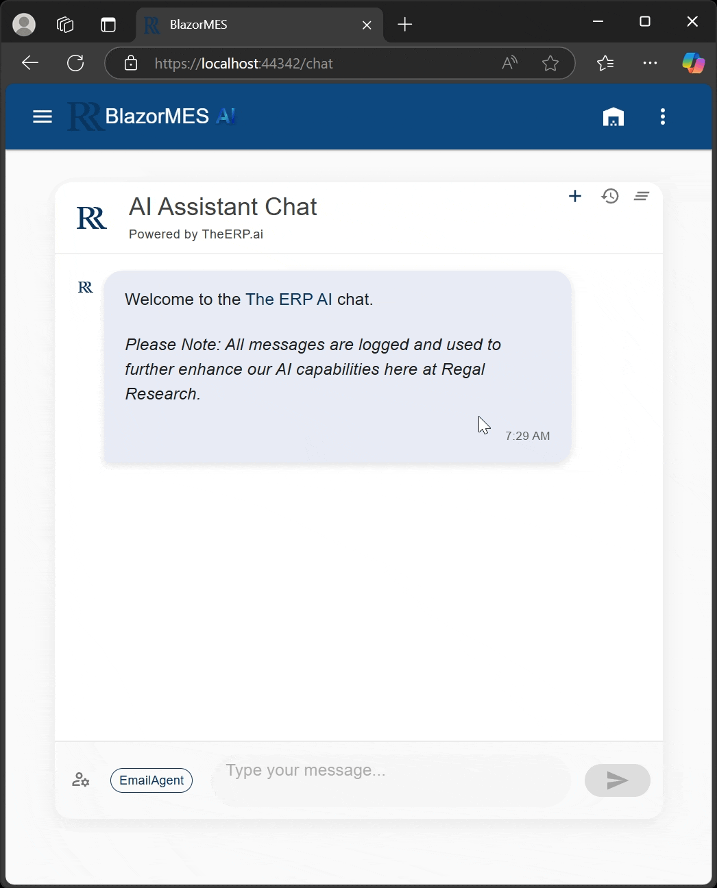

In response to Epicor’s nonsense release timelines regarding AI software, I got to work adding AI for on-prem.
I have examples connected to Epicor, but nothing quite ready to show off. Captured this just now, it is Claude’s family of models connected to Google web search, all through our own API keys and orchestration. I even have it connected to MS Graph. The note regarding message recording is for our internal users to be aware. The AI companies themselves do not log your API calls (if you pay).
Azure OpenAI, OpenAI, Google Deepmind, Anthropic, and xAI. All in one. :smiley:
*All WIP
Recording 2025-03-28 at 07.32.37
