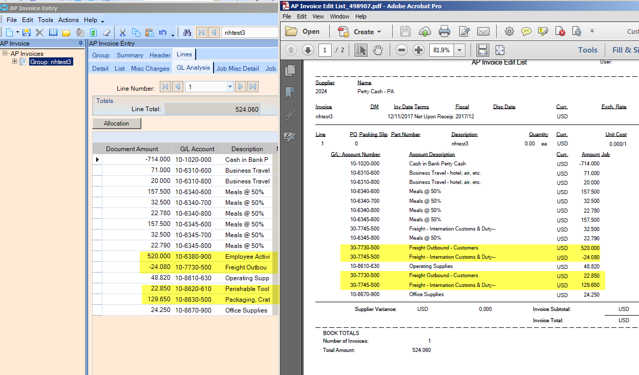

Good Morning,
We are having an occasional error in AP invoice entry where the accounts on the Lines / GL analysis tab do not match the accounts on the edit list nor the accounts that get posted to. See screenshot. It feels like it has something to do with the way that the user enters the accounts but it’s squirrely and I have not been able to reproduce 100% reliably. :frowning: I know if I paste insert the amounts and account numbers from Excel I never seem to get the error. It’s only occurred with manual typing.
