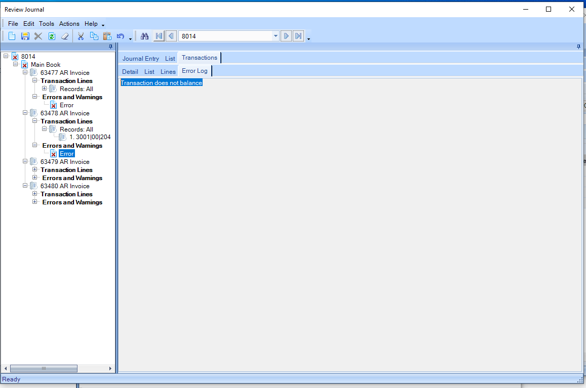

Hello,
Would any one know why Transaction does are not balancing when posting invoices
Most likely related to a GL control issue or a currency rounding problem if you are multi-currency
Also, you will want to verify the GL account exist.
A problem with the gl control may be it as our accounts department could has changed something.
here is a warning i also found - Rule Post Invoice Amount to Accounts Receivable was executed but didn’t produce a complete transaction line. Account, Amount were not defined
I would run a Chart of Accounts listing if you have access to that section of the system. Check to make sure the following account combination exist. 3001-00-204. The numbers maybe in a different order on your chart of accounts, but see if this combination exist. If it does not then this transaction is being coded to an account that needs to be created, or is being coded to an account that was accidentally entered on the AR invoice. Let us know what you find.
Does the edit list for this group balance? You can open up the Review Journal and go to Actions > Review Journal Cancellation and it will put this invoice back in the AR Invoice Entry group screen for review. You can run an edit list from there and see if the GL Summary is out of balance or not on the edit list.
