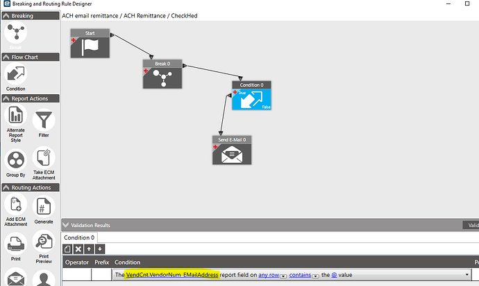

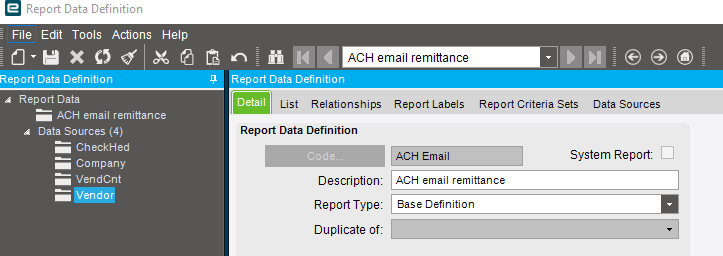

As discussed here: I am trying to setup an AP remittance email SSRS Breaking/Routing. I have created a new Report Data Definition:
My current Routing:
However when comparing my conditional statement to this user above, my VendCnt.EmailAddress comes up as VendCnt.VendorNum EMailAddress and I believe that is what is causing my routing to not work. I have tested this by posted an AP Payment Entry but I get no email. Any help or suggestions would be great.
