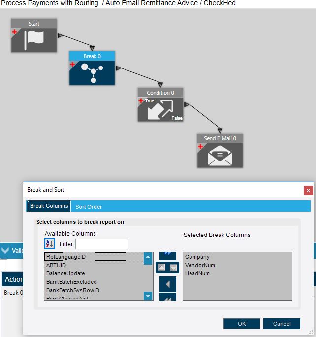

We have it working, what table and field do you break on?
We have it set to break as per the below and seems to work fine.
Thanks for you reply Ron, I have tried various options such as Vendor or CheckHed. I believe my issue lies in the report data definition and the tables I’ve added and not created the Report Relationships correctly.
Thanks for this its a big help. This has got my remittance advices breaking correctly, however I am getting inconsistencies in email results. Are you able to provide any useful screenshots of the data definition where presumably you have had to add additional data sources and report relationships. I presume you are using the primary purchasing contact as the recipient for the remittance advice?

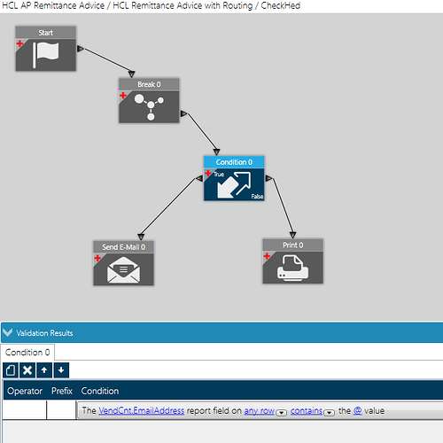

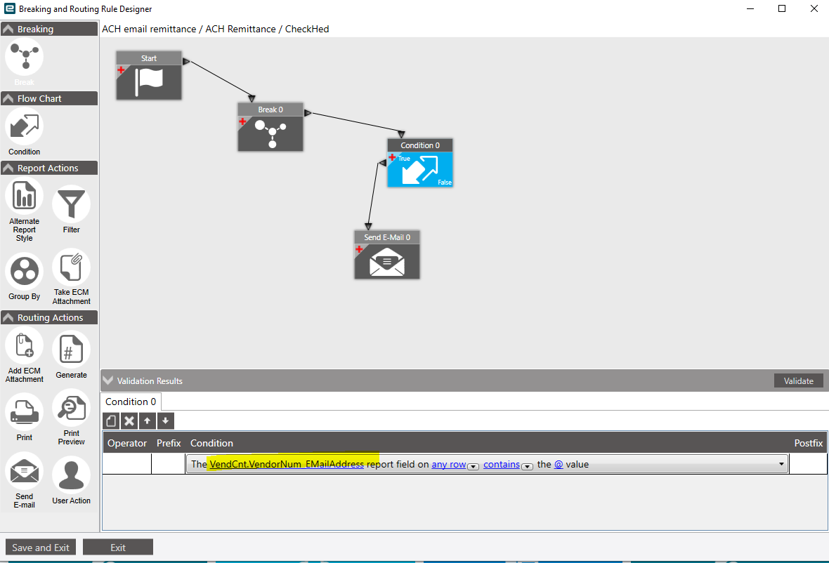

Hi - can anyone share your routing? I am trying to do the same thing and would like some guidance on setting this up

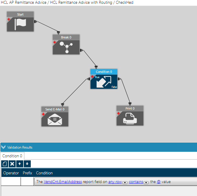

Curious to see what you used in your condition block?
Hi - this is mine, has been working reliably since I raised the topic

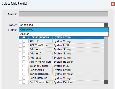

Thank you Darren! This helped - I was looking for a Posted = True but this would work! Btw how do you add VendCnt to the tables here? I only have CheckHed and ApTran.

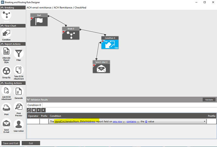

Hello - how come mine says VendCnt.VendorNum_EmailAddress?
Hi I have multiple Vendor Contact, how do you make the remittance record not duplicated?
Do you mind sharing how you got the VendCnt to show in this list?

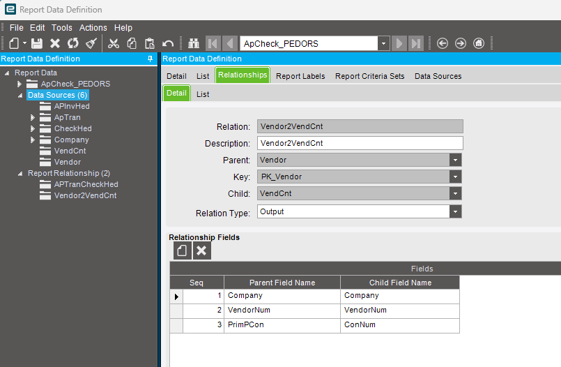

You’ll need to edit the related RDD (Report Data Definition) to add that table (and set the relationship for the join)
I think I did that correctly, but it doesn’t show up
I’ve had the issue before where the changes werent shown in the routing. Perhaps try to disable the routing then re-enable to see if the changes get picked up.
