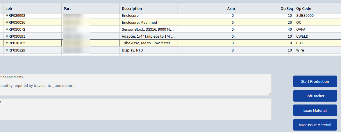

I have an app that displays a list of jobs and has buttons to launch Start Production, Job Tracker, Issue Material, and Mass Issue Material with the job number from the selected row.

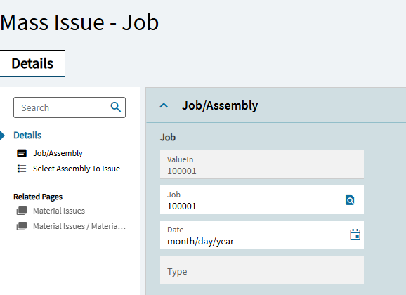

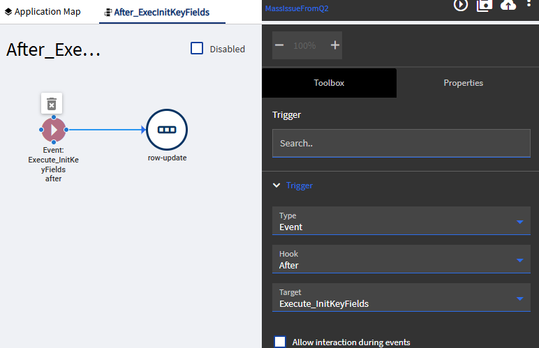

Interestingly enough, I was able to pull it in during an event set to Event → After → Execute_InitKeyFields

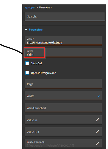

You’ll need to do a row-update and assign the column manually. It’s definitely coming through with valueIn, as I was able to bind it to a call context field and display it in a text box. However, it seems the event that sets it isn’t getting called.
So on your button event, you’ll need an app-open with the customization layer
Then on the MassIssuetoMfgEntry you’ll need a layer with an event as such:
With the event set to After Execute_InitKeyFields
And a row-update widget set to a column of KeyFields.JobNum and a value of your “%session.context.intialValueIn.ValueIn%”
Tada!

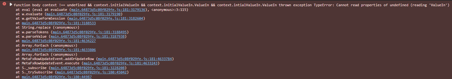

Still not working for me, however, I’m getting a different error message. I assume I’m missing something simple here, but my setup looks like yours as far as I can tell.
Error:
Cannot read properties of undefined (reading 'ValueIn')

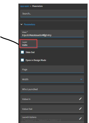

Button Click Event
MassIssue After ExecInitKeyFields event
What does your row-update look like in Parameters and Columns?
Can you output a debug slider message in your event before the app-open to see the value you are passing?

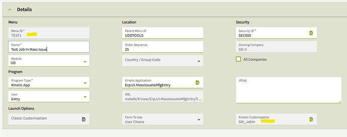

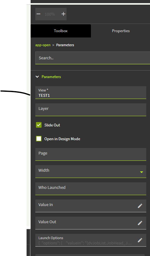

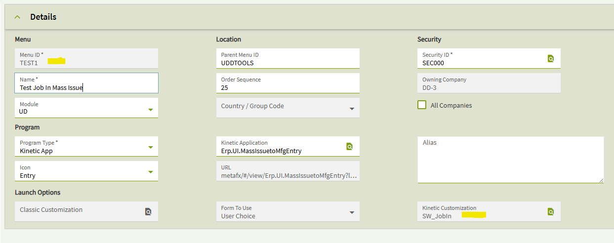

Hi @nhutchins , I finally got it to work. Watch when you use variables, they are case sensitive:
I couldnt get Layer to work
So…
I used Menu item by Id
In Menu Maintenance :
Kinetic Customization is SW_JobIn. Set up like in above.
Hope this helps ! I Know the feeling, Head hurts from banging on the desk sometimes :face_with_head_bandage:
