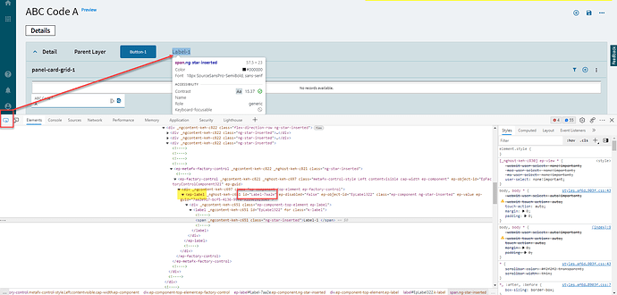

  1. Place your label and save your layer
  2. Preview your layer and open Dev Tools (F12)
  3. Select the label element to inspect
  4. Grab the id from the ep-label component. (Not sure why this isn’t exposed in App Studio… @bconner ?? )

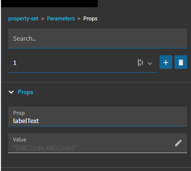

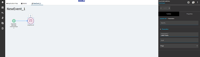

  1. Create an event. Set the trigger to whatever you need it to be to invoke the change.
  2. Add a Property-Set widget and set the Components property to the label ID you found in your layer JSON.
  1. In the props, set the Prop property to labelText and set the Value to be {View.Column}
DynamicLabel
Thanks! I was wondering if I could use property-set to accomplish this. I’ve tried to use it for other use cases, but it either had no effect or I couldn’t guess at the correct property name. It looks like they’re camel cased?
There was a version where the property-set widget only worked on native controls. Depending on how long ago you tested, that could be it.
As far as the syntax, yes–it’s camel case.
