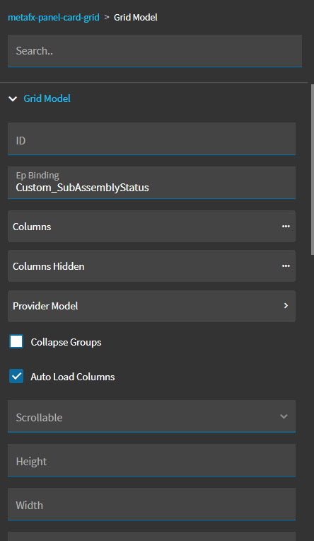

then on the grid, I’ve set the following:
with no other options.

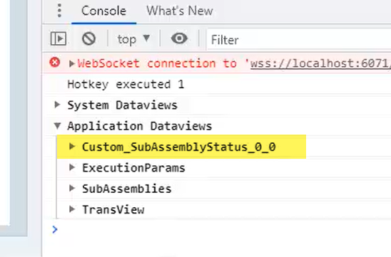

Press F12 to open Dev Tools, then click your application and press CTRL+ALT+8 to turn on debugging. Then press CTRL+ALT+V to look at the views.
Thanks for the tip! That gives me a lot more visibility. It seems that my dataview is not being populated from the rest-erp results. Is some other step necessary to initialize the data view? Or should a blank, custom data view be populated simply by specifying its name in the “View Name” fields of Rest Services/ERP Rest Arguments/Response Parameters (as in the screenshot above)?
If you’re just trying to display your BAQ in a grid, then you don’t really need a view. You can just set the BAQ ID in the provider model of the grid.
This is the only field I set on the Panel Grid.

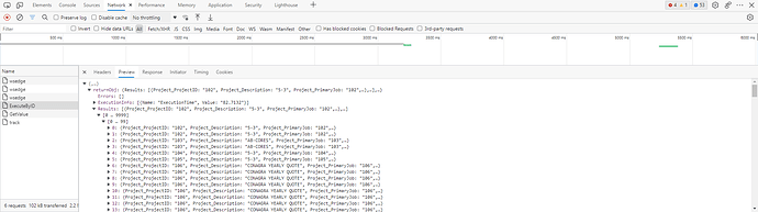

Okay, try this: preview your layer, open Dev Tools and press CTRL+ALT+8. Then click your button and go to the Network tab of Dev Tools. Do you see ExecuteByID in the list?
If so, click it and click the preview Tab. Do you see your query results there?
I really appreciate your help with this. Yes, the results are being returned. I recorded a quick screencast that shows how I have everything set up and the developer console results:App Studio rest-erp view issues

  1. You showed the dataviews in Dev Tools, the BAQ ran, then you looked at the old dataview data. The stuff that displays is static, so you have to press the hotkey again to pull new results.

  3. After correcting the grid model binding from Custom_SubAssemblyStatus to SubAssemblies, did you recheck the views in Dev Tools? Based on your video, you have it currently bound to Custom_SubAssemblyStatus and I see a view called Custom_SubAssemblyStatus_0_0 which is usually created at runtime when a view doesn’t exist.

  1. …so you have to press the hotkey again to pull new results.
Pressing again still shows an empty view.

  1. …After correcting the grid model binding from Custom_SubAssemblyStatus to SubAssemblies, did you recheck the views in Dev Tools? … you have it currently bound to Custom_SubAssemblyStatus and I see a view called Custom_SubAssemblyStatus_0_0…
This layer has been added to a converted dashboard. The Custom_SubAssemblyStatus_0_0 data view is the one that was created during the conversion and can’t be removed. I’m ignoring it and creating my own for use with the rest-erp action.

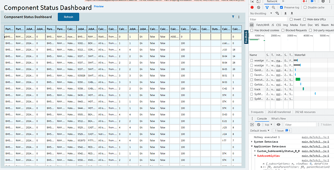

Got it working! :smiley:
Here’s what I think happened: I noticed two javascript errors in the console when testing that were complaining about missing event targets. When I first added this layer, I simply deleted the existing dashboard grid and added my own. This was because I couldn’t figure out how to get the grid to stop loading its BAQ. Binding it to the new view and removing the BAQ ID wasn’t working. Additionally, since events are no longer delete-able I ignored them.
This time around, I started from scratch on a new layer and hid the old grid and added a new one. I copied the configuration from the old rest-erp event action and this time it works.
This might just be a correlation but not causation thing, but it seems like those event errors were throwing a wrench in the rest of the works.
