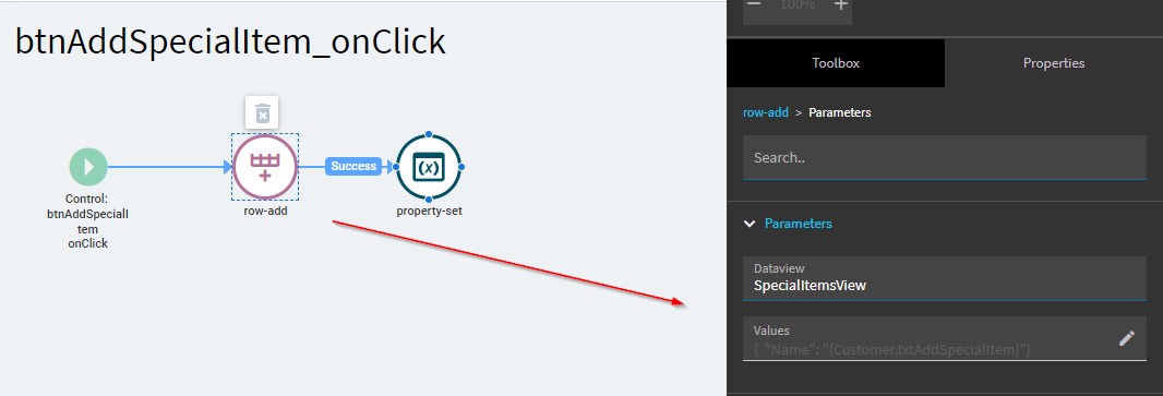

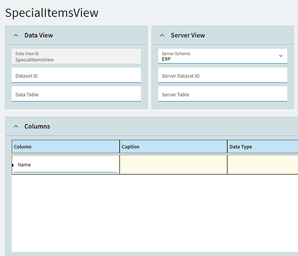

  1. Add a text box to current view ex: Customer
  1. Create a view with a column to represent the data
  1. Edit the button onClick event to add a row-add function followed by a propert-set to clear the text box.

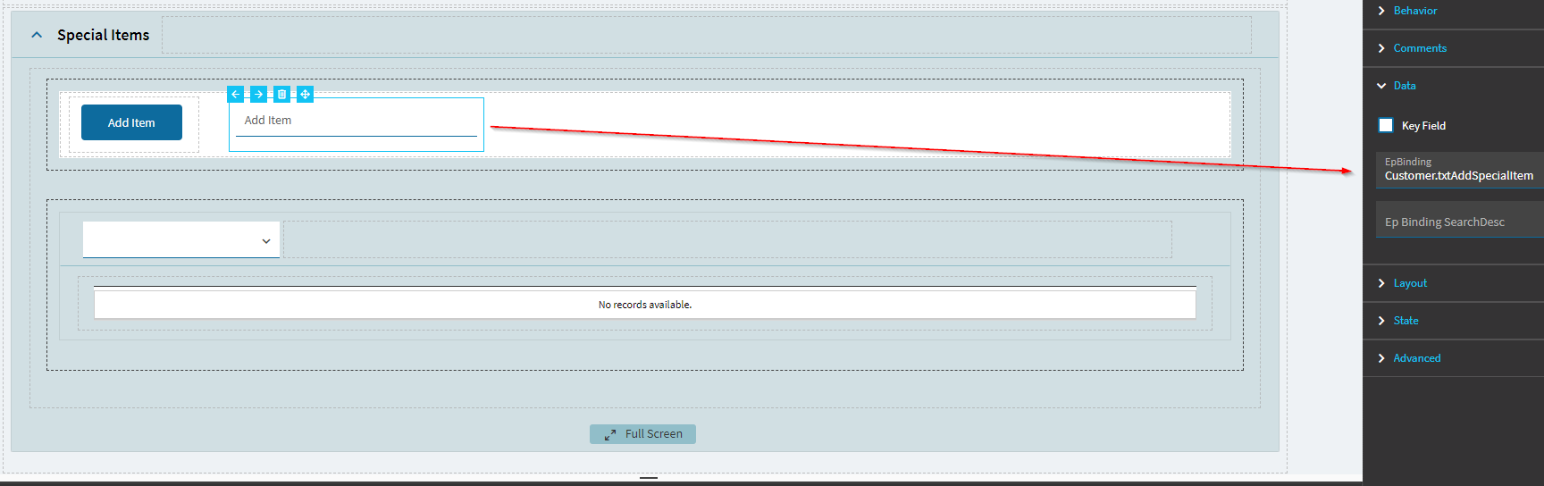

  1. Bind the text box to the new column in the Customer view.

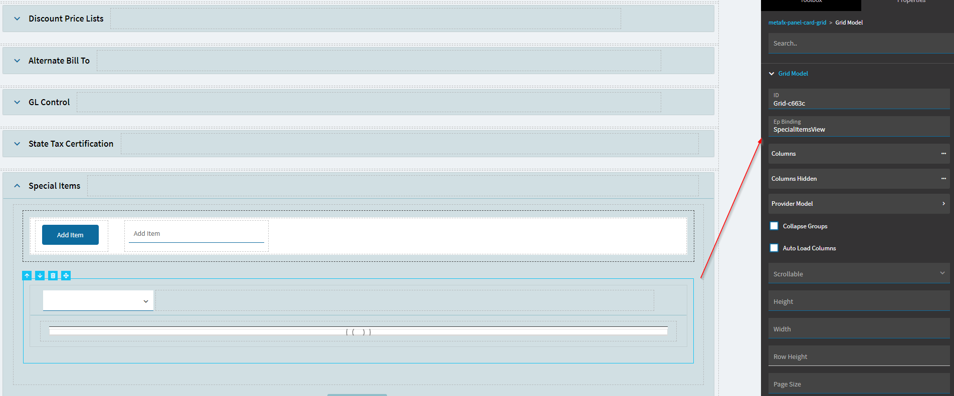

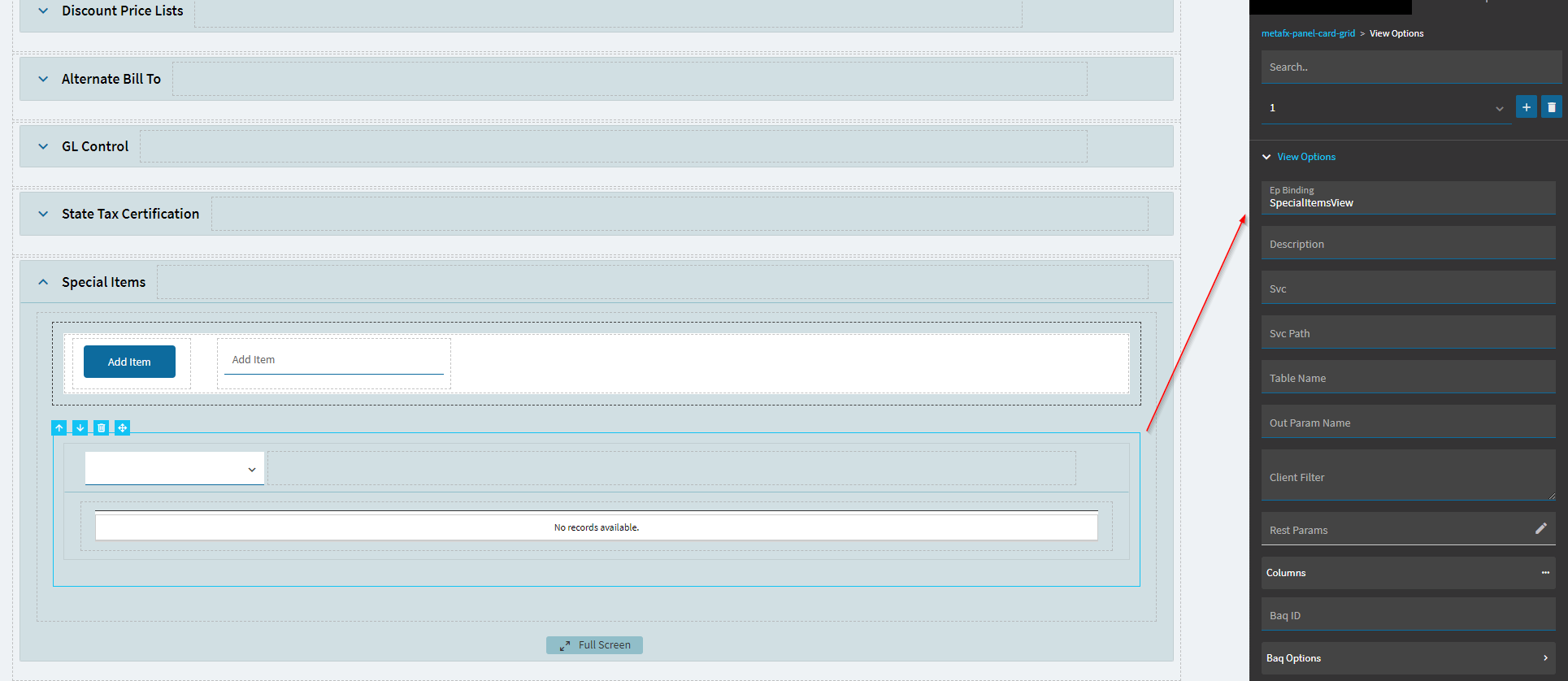

5. Add the custom view to the “View Options” > “ep Binding” property of the grid.
SEE REPLY BELOW
Looks like I a had the custom view in the wrong place. It needs to be under the “Grid Model”. This may be another topic but does anyone know where to find a list of properties that work for the “property-set” function in the event toolbox? I am trying to set the focus back to the text box after the item is added to the grid. Tried setting “focused” to true but didn’t work.

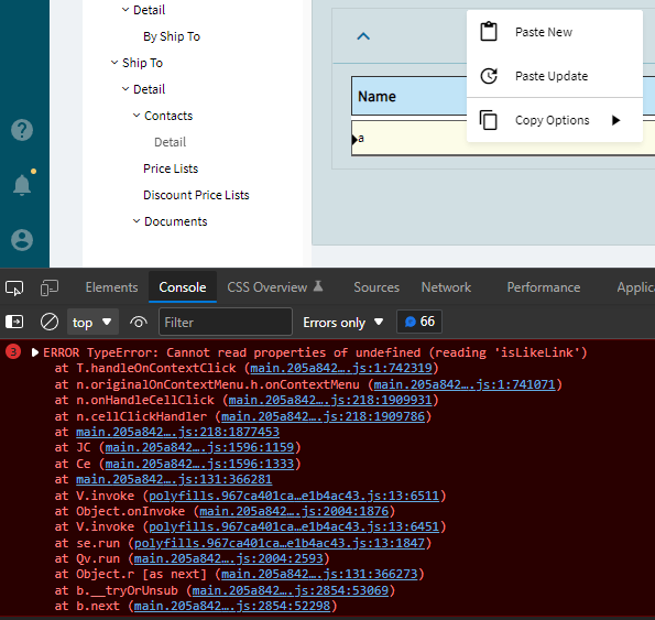

I thought I would see what would happen when I copied the items using the built in copy functionality and paste the results in Excel. It appears to past the correct number of rows but they are blank. I opened dev tools and see the error below when I copy.

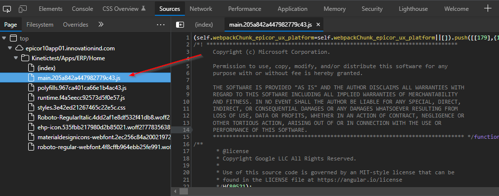

@josecgomez is there a way to run the “unbundled” version ,of Kinetic, in the browser so I could add break points for debugging purposes to be able to troubleshoot errors like the one above?
No but there are a lot of debugging options you can enable look in the docs

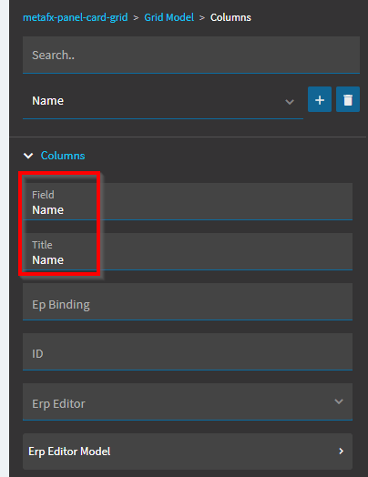

Looks like I needed to add the column to the “Grid Model” to match the one in my custom view. Now the copy works.
