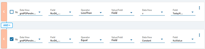

However, when evaluating the less than operator, it matches true for null values as well.
It would seem obvious to me that I could add a second condition to my row rule with an AND, and exclude null values, however this does not appear to function correctly on a DateTime? column. I’ve reported this as a bug.

Instead of checking the Not box for the condition and using the Equal operator, did you try it with the operator as NotEqual?
Yes, same output.

Contains + Value + Null

I did test adding an AND criteria, with contains = Null per your suggestion, and this did function as desired.

I also encountered this issue and tried this solution to effect. To clarify, the syntax is Contains > Value > Null. Ignore the Constant > NullValue option - it doesn’t work.
For dates, I added an And condition contains 2. It’s sort of a hack, but it works.
