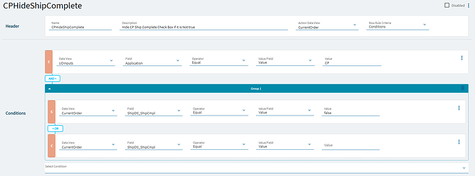

I have been trying to get this to work for a few days now with no success. I have a Data Rule that says IF ShipDtl_ShipCmpl = False or if ShipDtl_ShipCmpl = null. I know in this example that i can just say != true and it works, But other places where i would want to check null specifically don’t work.
As you can see even though the value is null it doesn’t trigger as true and disable the Shape component.

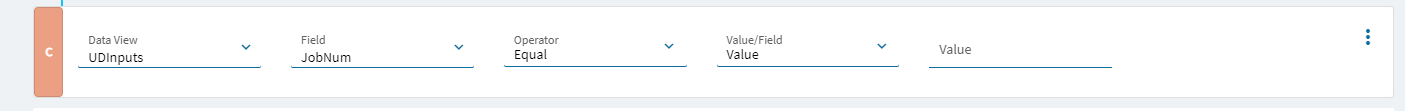

If you are comparing a string you can leave it blank, this will work.
If you are comparing a Integer you cant put a 0, this will work
but i can not figure out how to compare against a bool. Does anyone know?

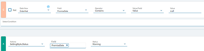

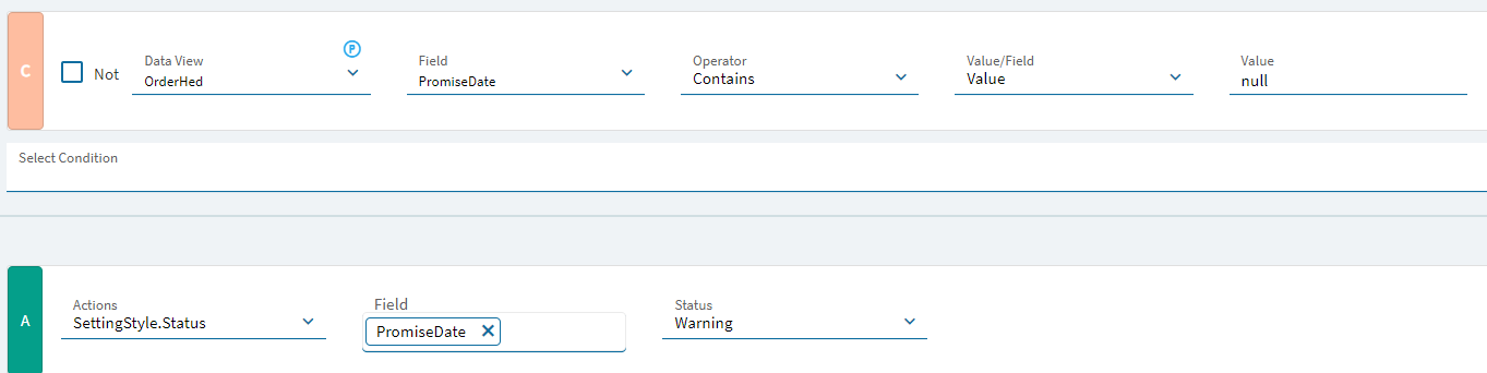

Change your operator… Try CONTAINS a value of null
Result:
Do you have any idea why Contains works here but elsewhere simply saying equals “nothing” works?

Well either way, thanks this was causing me to pull my hair out. using “contains null” appears to work on Bools and Strings at least for a dataveiw returned on from a BAQ query.
Thank you, this worked for me today

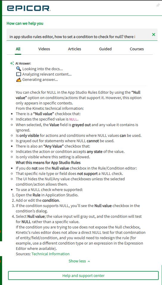

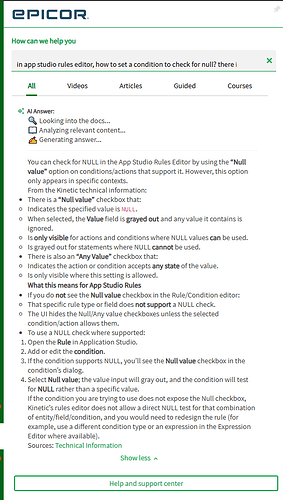

Ai-answers seems to think there is supposed to be a null value checkbox.
:robot: :roll_eyes:
I think the rules editor is broken. Whatever…
