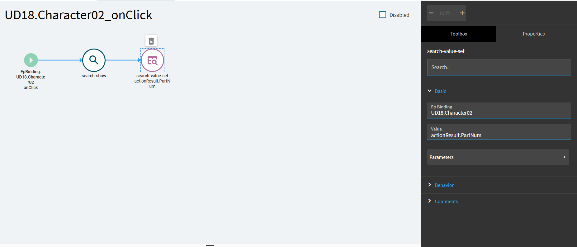

Hi all! So I have a chip selector that i want users to be able to select and add parts to when needed. It’s current able to do that for the most part. Current functionality allows:
  • opening search window, selecting multiple which adds to the chips.
  • Allows manual entry of the chips
Issue at this stage is that once the chip select has entries they’re being overriden if you try to add new entries via the search which actually makes sense to me. since I have a Search Value Set widget that the value is actionresult.PartNum.
I’ve tried a few things to no avail. Any tips on how to approach? I’ve never used this tool before so super confused haha.

I looked at this a little deeper.
The search-value-set indeed doesn’t evaluate expressions like other ‘value’ props It just assumes dataview.column and grabs the column name. So CustID from actionResult.CustID for example. Which explains why actionResult doesn’t even have data afaik
There are two modes to search-chip-selector affecting how results are added. Manual and Auto. Manual does replace and auto appends. It’s hardcoded to manual and drops into auto when you paste insert.
Unfortunately havnt found a way to set to auto so paste is the only way to add to existing selections as far as I can tell.

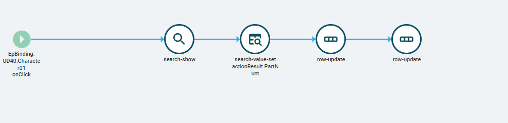

You can relatively easily make this work.
I made my OnClick event like the below.
  • Row-Update - Setting TransView.tempPartSearch to “”
  • Search-Show - As normal - Like = Part.PartNum, SelectMode = MultiSelect
  • Search-Value-Set - Ep Binding = TransView.tempPartSearch, Value = actionResult.PartNum
  • Row-Update - Ep Binding = UD40.Character01, Expression = ("{UD40.Character01}" !== "") ? ("{TransView.tempPartSearch}" + "~" + "{UD40.Character01}") : "{TransView.tempPartSearch}"

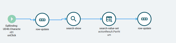

Turns out the Search-Show has to be the first in the event. Not to worry :slight_smile: moving the first row-update to blank out the temporary search field to the end rather the start and adding in the search validation restores that functionality while still maintaining the new append functionality.

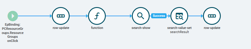

Some way to improve this solution is actually to not display already selected items in search results.
Example for resource groups
I hope that will help someone
  1. row-update. TransView.tempResourceGroupSearch = ““ and TransView.tmpSQL = ““,
  2. function.
    1. Name = convertDelimitedListToSQL
    2. Args = [“PCResourceGroups.ResourceGroups”, “C”, “~”]
    3. Output TransView.tempSQL
    4. DataType = String
  3. search-show
    1. Like = ResourceGroup.ResourceGrpID
    2. Pre Load Search Filter = “ResourceGrpID NOT IN ({TransView.tempSQL})”
  4. search-value-set
    1. EP Binding = TransView
    2. Value = searchResult
    3. Parameters → Columns = [“ResourceGrpID”]
    4. Paramaters → Multi Field Bindings = [“TransView.tempResourceGroupSearch”]
  5. row-update. PCResourceGroups.ResourceGroups = (“{PCResourceGroups.ResourceGroups}” !== “”) ? (“{TransView.tempResourceGroupSearch}” + “~” + “{PCResourceGroups.ResourceGroups}”) : “{TransView.tempResourceGroupSearch}”
