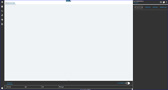

This is my base layer of Order Entry currently in 2024.2.7 (first discovered in 2024.2.4):

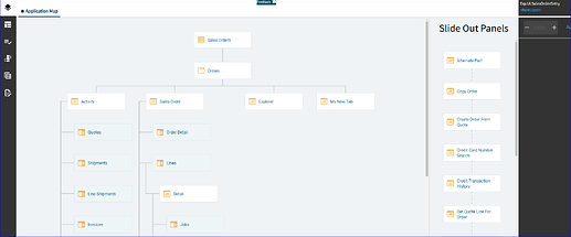

Yeah, looking at mine again (now in 2024.2.10)… PILOT was updated on 2/19/2025… Sales Order Entry base was updated on 3/5/2025.
There was an “incident” on 3/5/2025 where a bunch of cloud customers were affected… perhaps this was part of the “cause”??? Not sure, and they never said. But the dates line up! Maybe they were pushing out a hot fix?

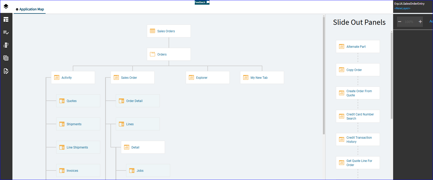

But anyway… the Application Map is back in the base form:
PRB still isn’t updated. Still shows “Accepted - Not Yet Planned”… but appears to be working now.
